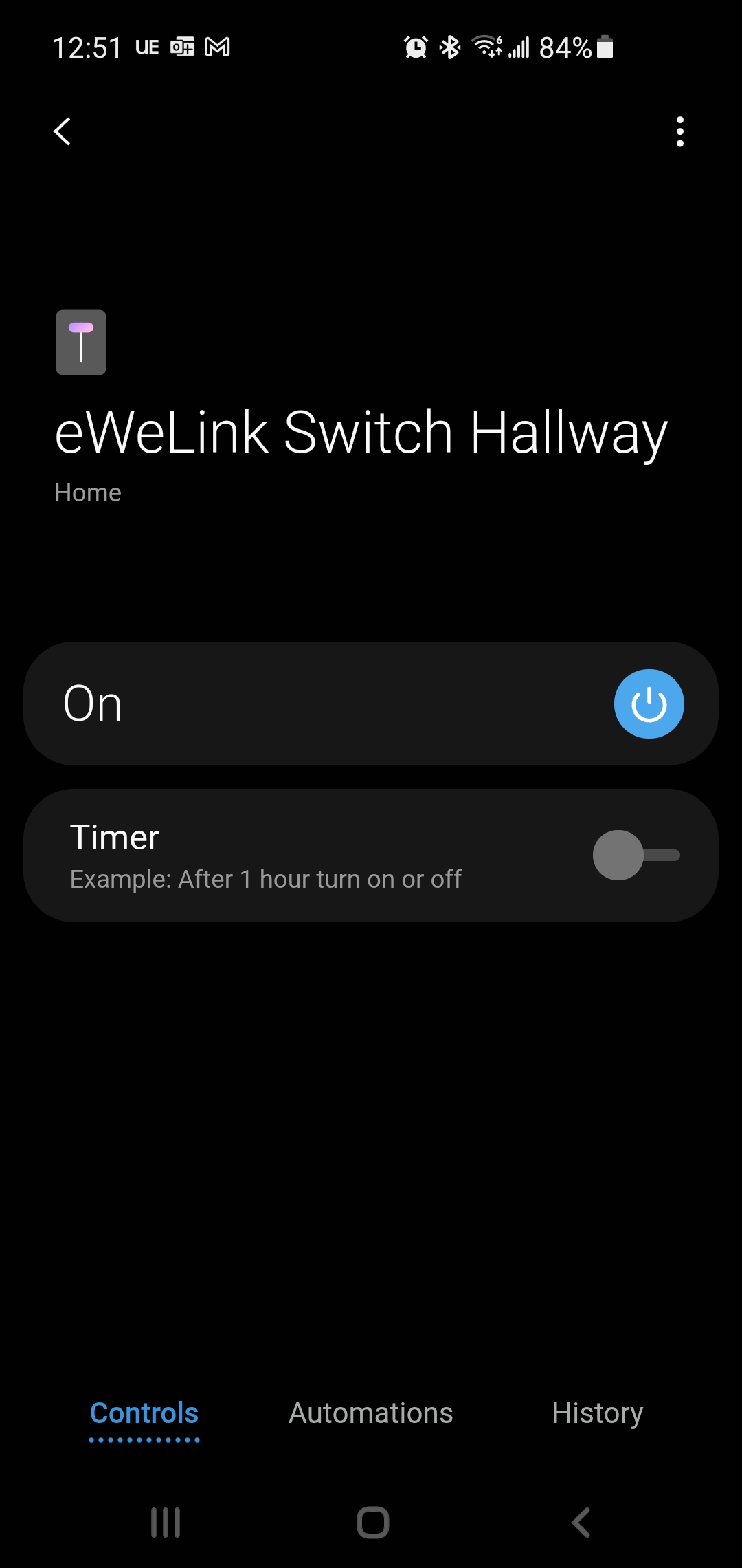

How do i change profile?
It came up as a switch, and it’s the plug
This how use to be
oh, you mean the device icon, right? That is defined in the metadata of the device profile. Mariano has changed this value successfully for other devices so, if this belongs to his released drivers, he can help you out.

@nayelyz and @Mariano_Colmenarejo yes, device icon. Previously it was shown as plug, now with Edge driver shows as a switch, which is incorrect. It should be the plug.
It’s already changed.
There are two models from the manufacturer ewelink that are identical, one is a switch without external switch input and the other is a plug.
I have put both, I will remove one, with the plug icon, @nayelyz, I do not see a way to differentiate them in the fingerprint

I have this one, which identifies with the manufacturer and model exactly the same as your plug.
They cannot be differentiated in the fingeprint.yml file.
You can put a different id. and different profile, but it matches the one it wants, since they have the same manufacturer and model.
can make 2 different drivers
If you pair it again it will have the plug icon
I could switch the edge driver if wrong one is associated. I could have choise to switch from switch to plug, and vice versa.

The dth is zigbee switch and this fingerprint:
fingerprint profileId: "0104", inClusters: "0000, 0003, 0004, 0005, 0006", outClusters: "0000", manufacturer: "eWeLink", model: "SA-003-Zigbee", deviceJoinName: "eWeLink Outlet", ocfDeviceType: "oic.d.smartplug" // eWeLink SmartPlug (SA-003).
But for my switch, which has the same fingerprint, I put the switch icon.
Aren’t they these fingerprints? I see one is for the Outlet and the other one for the Switch, but the model is different:
The switch has the model ZB-SW01
You are right @nayelyz, that’s my plug (outlet)
