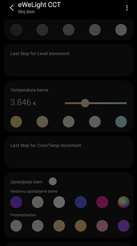

Hello.
Thanks for adding it. It works good enough :wink:
Works fine the color control?
Dimming buttons - working
Cct slider - working up to 90% of cold white
Cct buttons - working
Color management - RGB presets, last used = obsolete for my case.
