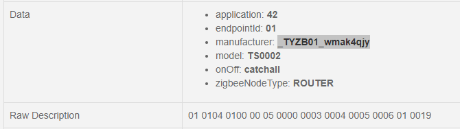

Hey @Mariano_Colmenarejo
One more Zemismart Touch panel Zigbee multi switch working fine with Integrated Zigbee Swtch Handler:
Data
  • application: 42
  • endpointId: 01
  • manufacturer: _TYZB01_wmak4qjy
  • model: TS0002
  • onOff: catchall
  • zigbeeNodeType: ROUTER
Raw Description 01 0104 0100 00 05 0000 0003 0004 0005 0006 01 0019
TY!
