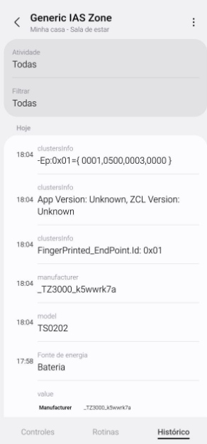

Hi, Mariano!
I think i’m doing something wrong here… Would you help me, please?
When I pair the device, it automaticaly appears like a moisture sensor named “Generic IAS Zone”, with the driver “Default Clusters”.
Then I change for “Zigbee Thing MC” driver (is that correct?), but it goes for a Generic Device:
Although I have the other drivers (like Zigbee Motion Sensor MC), they aren’t on the list to choose:
What am I doing wrong? Thank you so much!
I see that you have the latest version of zigbee motion sensor Mc installed from 2024-11-28T10:27:48.997179295.
Sorry, there is an error in manufacturer code, the correct is _TZ3000_k5wwrk7a
You need uninstall device
Install this driver version in your Hub
Pair device with with this driver version, you do not perform a driver change from zigbee thing

That’s right! Worked!
Thank you so much, again!
