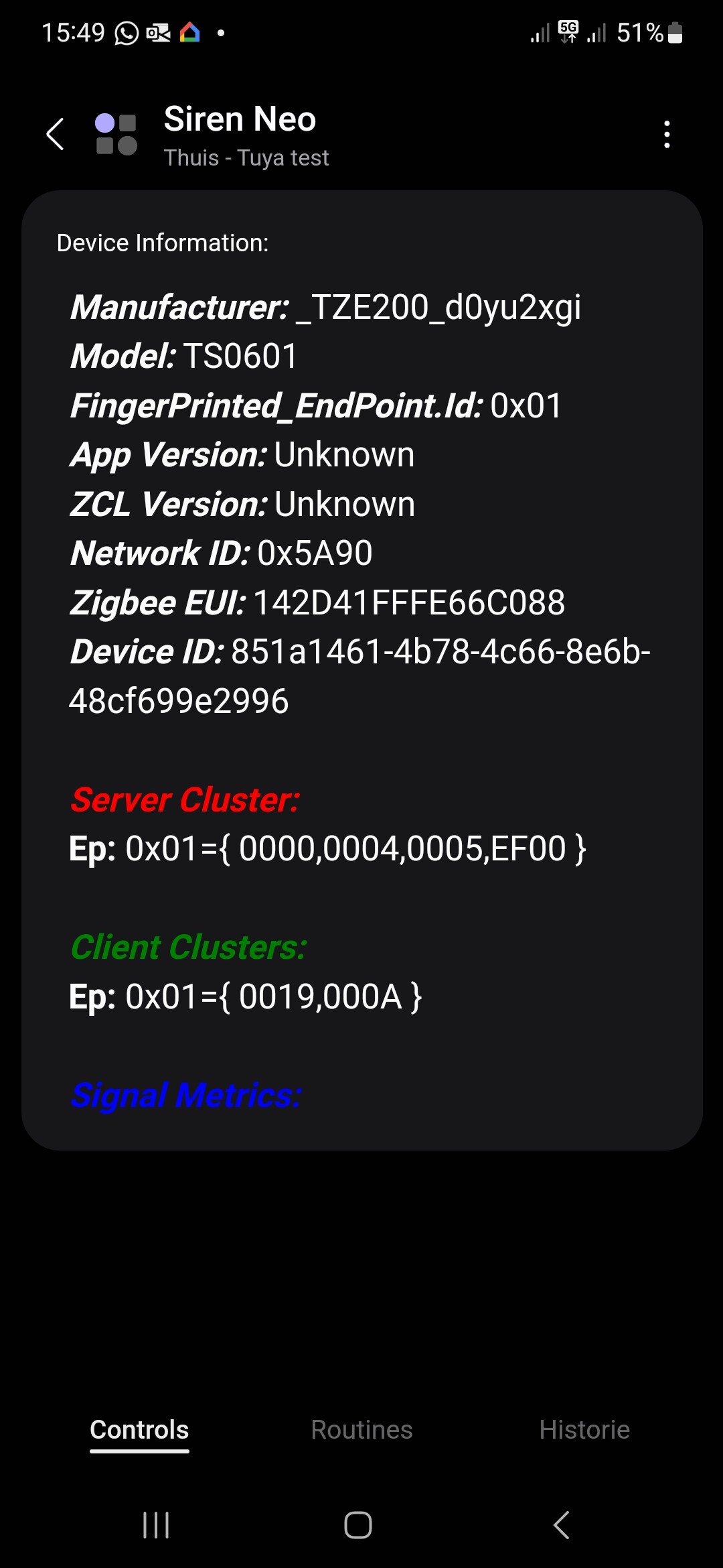

I bought this Neo zigbee Siren on aliexpress, do you think it is possible to add it to your driver?
Tuya Zigbee Smart Siren Alarm Temperature Humidity Sensor Home Security with Strobe Alerts Works With TUYA Smart Hub - AliExpress
It is possible but with @w35l3y driver, since this device is using EF00 cluster.
This is his tread you better try his driver first
