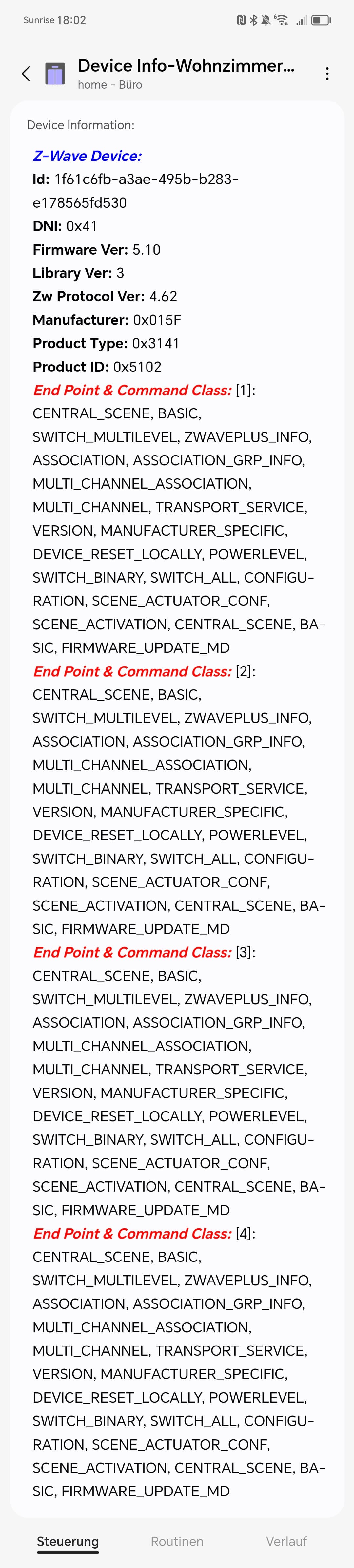

Here the device info.
Your device shows 0000 in the fingerprints.
This means that it has not been paired correctly. You usually need to move it closer to the hub during pairing.

I hove now another issue. The 4 gang switches is properly configure, but the switch 4 does not show. For the two Gang switch the β€˜main’ switch is controlling only one switch. Whereas for the 4 gang it is still the main switch, thus I cannot control switch no 4.
For multi-component devices, the smartthings edge philosophy from the beginning was that the main component controls physical S1, switch1 controls S2, switch2 controls S3, switch3 controls S4 and so on.
For zigbee I changed it from my first drivers, but for zwave I didn’t change it to match smartthings and I’m not going to change it now.
Therefore when you press switch3 it will control the S4 of your device.
Yep, I’ve messed up the numbers but this is not the Problem. I o la yan control 3 of the 4 switches, this is the Problem
Pelease, publish the fingerprints from smartthings adavanced users
Here you go
@tomkaja
It should work fine, but install this version of the driver.
