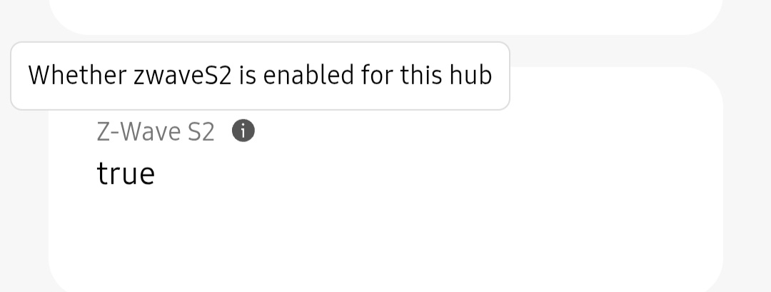

It is enabled. I appreciate your help with this. Worst case, if I can’t get it to work, I’ll get a wi-fi enabled smoke detector that comes with an app. I can’t find any good choices for smartthings. Too bad First Alert stopped making the zcombo. That worked fine.

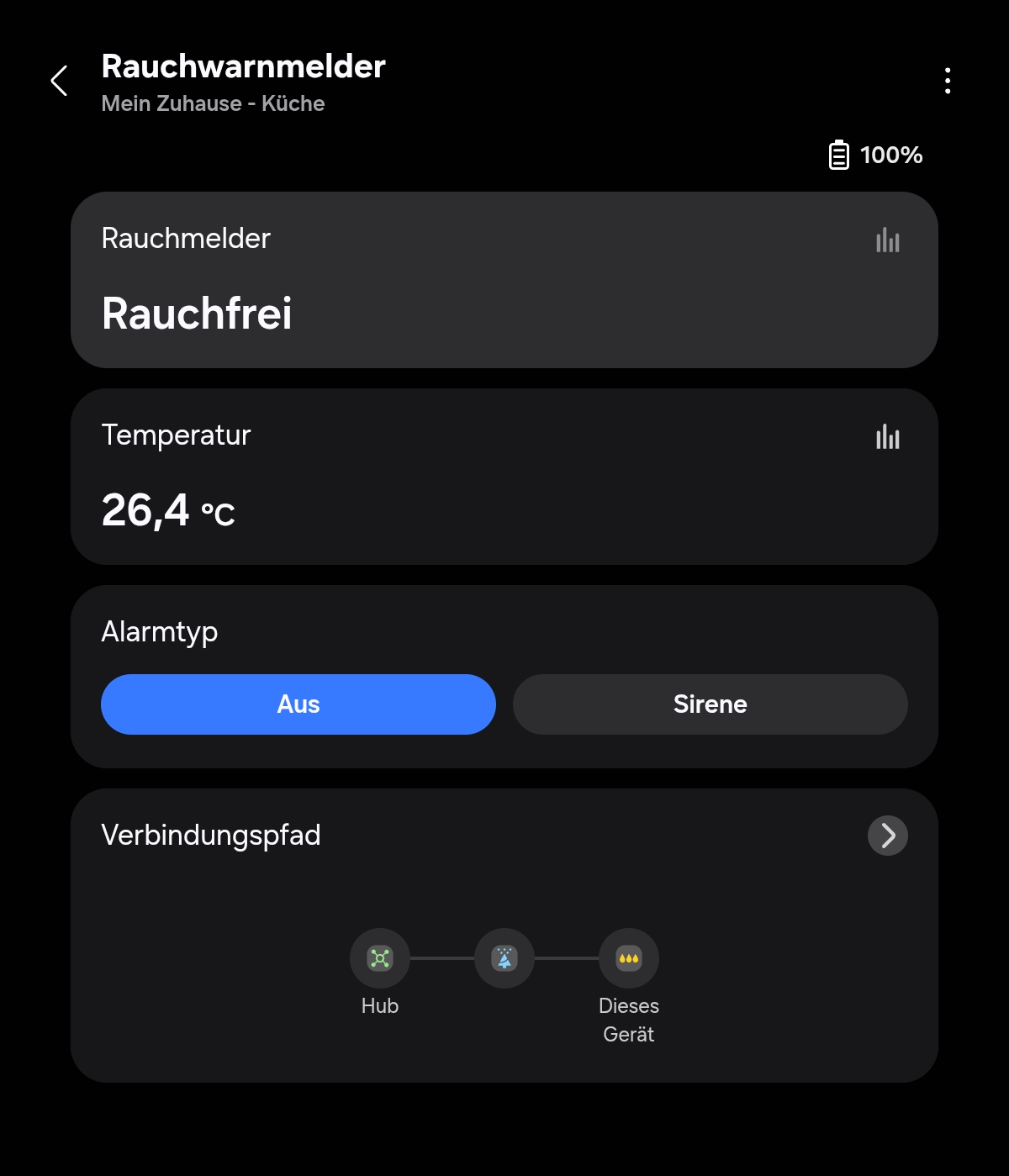

Don’t. WiFi is never a good idea for devices like that. I have Zigbee smoke detectors from Frient and they are awesome. Built-in temperature sensor and the siren can be controlled:

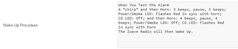

Can’t forget the Wake Up Procedure (according to the Z-Wave Alliance page) which could also be helpful to someone.

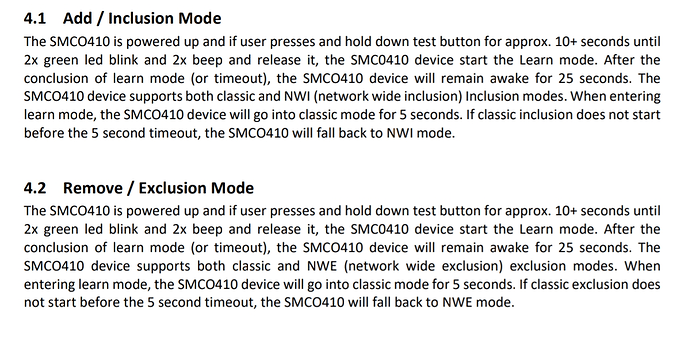

I think part of the problem may be the limited 25-30 seconds or so the detector seems to allow (5s classic mode either concurrent with, or followed by, 25s awake time) for it to be detected, authenticated, and paired which requires multiple actions to accomplish. At the same time, I’m not an expert in Z-Wave so I don’t really understand what network wide inclusion/exclusion is.

Classic mode is when you put the hub and device into inclusion mode. In the classic inclusion mode, the device sends a NIF (Node Information Frame” to advertise itself to the network, which should include its capabilities. This is the learn mode. After that the Network inclusion can start. This is where I think things are going wrong with SMCO410 device. Maybe that 5 seconds is just too short but I am speculating.
