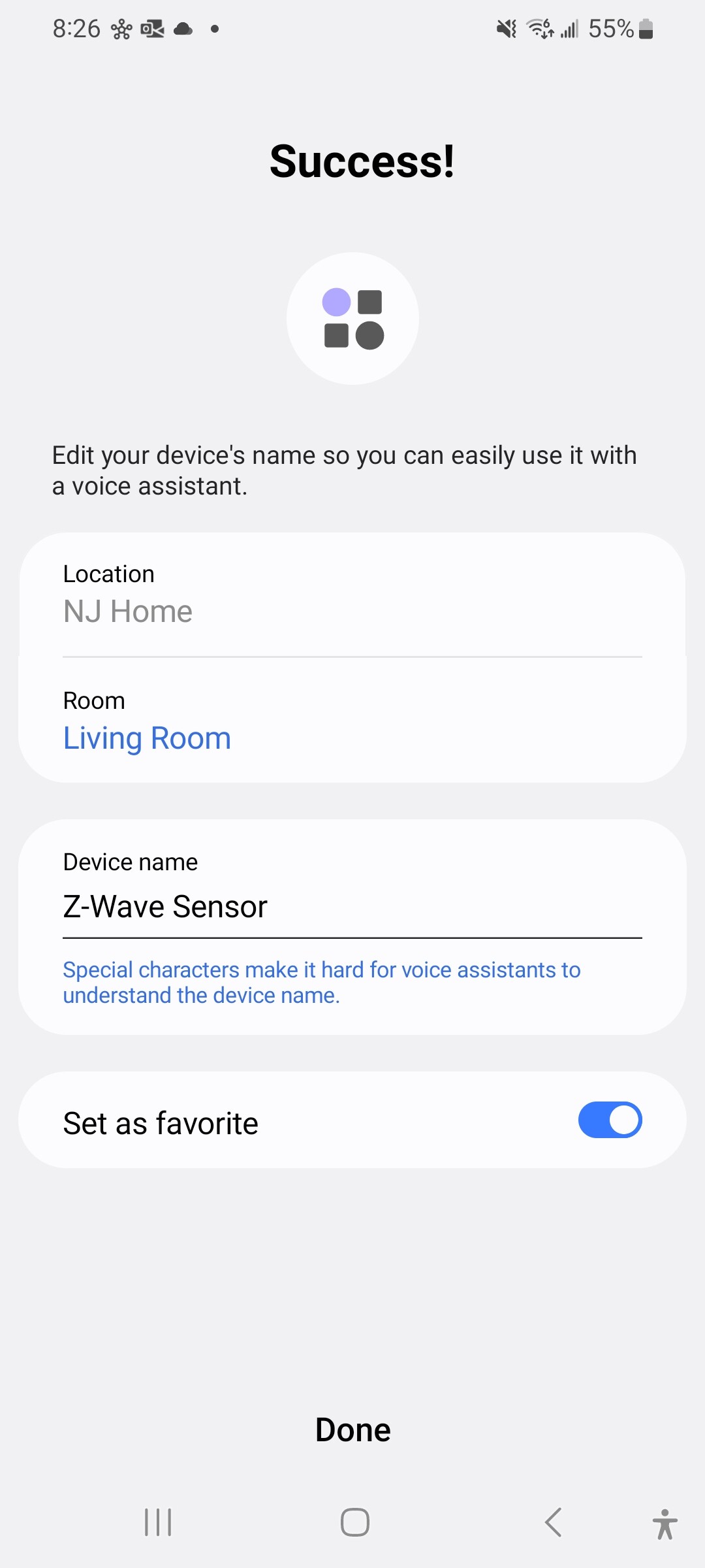

OK. I excluded and scanned and it added it again as a zwave sensor
I used the QR code this time

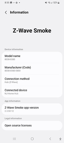

There’s another screen called Information with the most interesting information.
And what is shown when you click on Select different driver?

Manufacturer and model is “empty”. Read this (thread):
