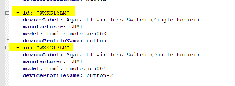

Any updates? @veonua could you please add to driver wireless switches WXKG16LM and WXKG17LM?
Both switches already supported by @veonua driver.
@dotan_shai So why it shows as zigbee thing with no control? Could you share invitation link with it?
Sure , it is @veonua channel, go ahead and give it a try:
I enroll veonua channel. There are no support E1 wireless switches. Where did you get this screenshot?
