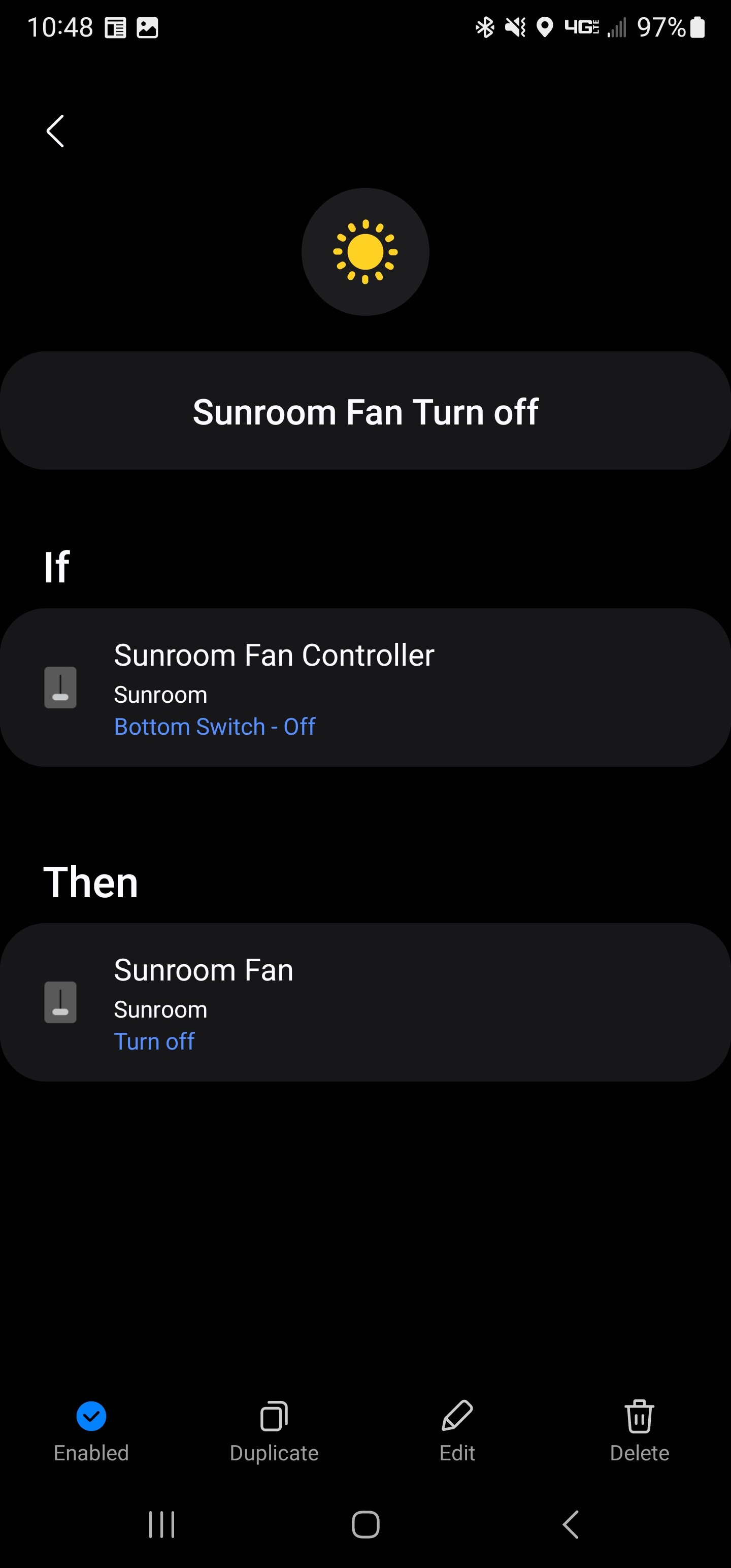

Sure!
First, create a virtual switch via the advanced web app by going to Devices and clicking on Add a new device. Fill in the details that show up.
Next, create a new Routine/Automation that includes the virtual device and the actual switch. Here’s my setup for On and Off. You could use the Smart Lighting smartapp and use the “sync” function, but I’ve found that slower than using routines.
Thanks, this got me going.
I could not quite figure out how to get a routine to only control the second power switch individually, but this still got me what I really wanted, which is being able to turn them both on or off together and use a zigbee button with a super routine to turn these lights off all at once with all the other lights in the house.
Your routine shown above has just “bottom switch-on” and in mine, I seem to be limited to having to have top and bottom switch treated as one together. I tried creating a routine as a stand-alone and selecting the device, and I tried creating a routine from the device.
