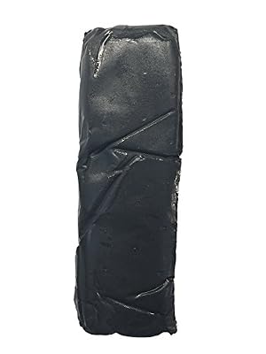

The weird fluctuation may be 'coz of the hole behind the thermostat. I was going to get this thingie…
Look at this picture. Does anybody know what that thing is that the user used to seal the holes…
http://www.smarthomehub.net/forums/discussion/331/new-setup-few-questions
I did read that and it makes sense!
I was just going to use silicone caulk as it’s easy to apply and remove if need be.
People will usually use closed cell foam or silicone caulk, but I hate anything I have to chip out again.
If you want a nice solution that’s still easy to change out, just add a base shield behind the thermostat. This lifts it up off the wall and gets it reading room air temperature again.
