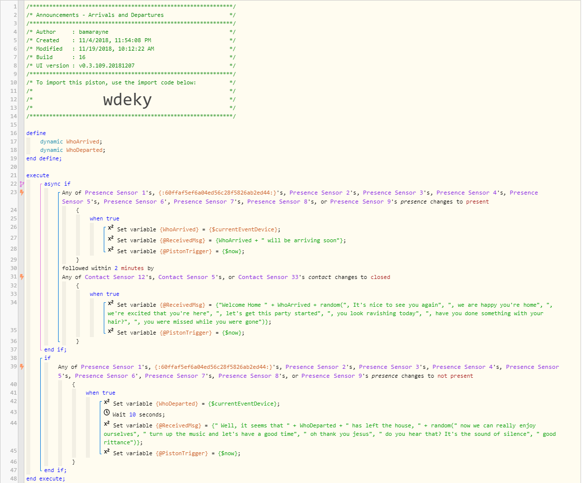

Using webCore, what is the best way to feed your own set of phrases to echo speaks and have it use one at random?
You can search in this topic for “random” to find a few examples. Here is one from @bamarayne

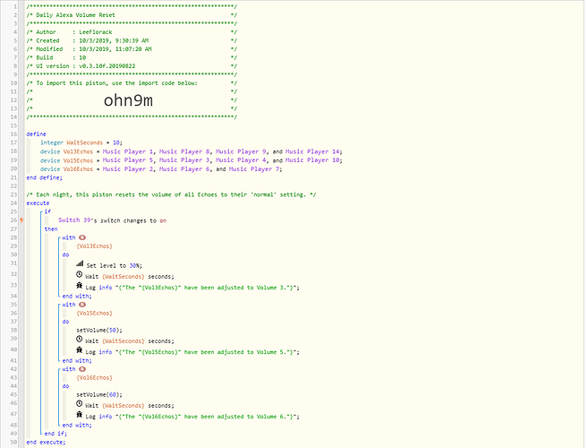

I know this is an old message, but I’m looking to do the same thing with my 11 Echo devices and I’m having difficulty in making it work. Using webCoRE, I’ve tried both the setVolume(30) and the setLevel to (30) commands and they aren’t working. I just want each of the echos to set their volume to a preset percent every night (the test piston is using a virtual switch for now) so that it’s at the proper volume each day.
Here’s my test piston:
Thanks in advance for any help.
Lee
Replying to myself…
Here’s the piston I came up with to reset the volumes on my (11) Echo Devices in case they’ve been changed during the day:
