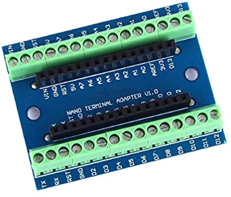

@djh_wolf You buy a nodemcu and a breakout board, you download the konnected flash tool for diy kit (free), you wire up sensors to the breakout board (you could wire them up directly to the nodemcu but it is not recommended). Don’t buy GPIO breakout boards like me, they were a terrible choice. Buy these: WYPH Nano Terminal Adapter Shield Expansion Board for Arduino Nano V3.0 AVR ATMEGA328P-AU Module (Terminal Adapter 3pcs) https://www.amazon.com/dp/B07K8KM583/ref=cm_sw_r_cp_tai_kUXbFbMR5D16F instead. They have screw terminals instead of GPIO and reduce headaches. Same price. Then use this https://docs.konnected.io/security-alarm-system/wiring/contact-sensors for wiring the devices. You need to give 5-10v (but no more!) to the vin pin and gcc pin next to it to power the nodemcu. It is ok to power by the USB port but not recommended. If you need a siren, then you need to buy a relay (must be 3.3v high-level relay with the screw terminal breakout board!: 1 Channel 3V Relay High Level Driver Module Optocoupler Relay Module for ESP8266 Based Board https://www.amazon.com/dp/B0798CZDR9/ref=cm_sw_r_cp_tai_35ZbFbR63F2QJ and a siren power supply (usually 12v). Finally, if you buy new nodemcus for 12 and above zones, then you just wire the power in paralell. It is not as hard as it seems.

To clarify, I can buy this (amazon uk):
…and this… (amazon uk)
Then wire it up as per here:
