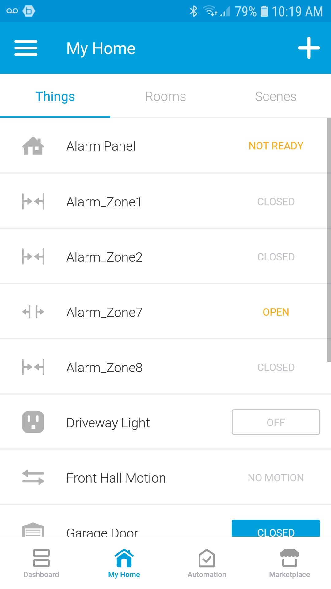

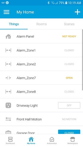

My old software integrated with the DSC alarm panel using a IT-100 board, so I wanted to do the same. I found one project (NodeAlarm) that was using the IT-100 so I decided to give it a shot. The software didn’t work out of the box for me (I think because I have a 3rd gen hub and I think it was written for 2nd gen hubs), so I made some changes and it seems to be working very well. Screenshots below.

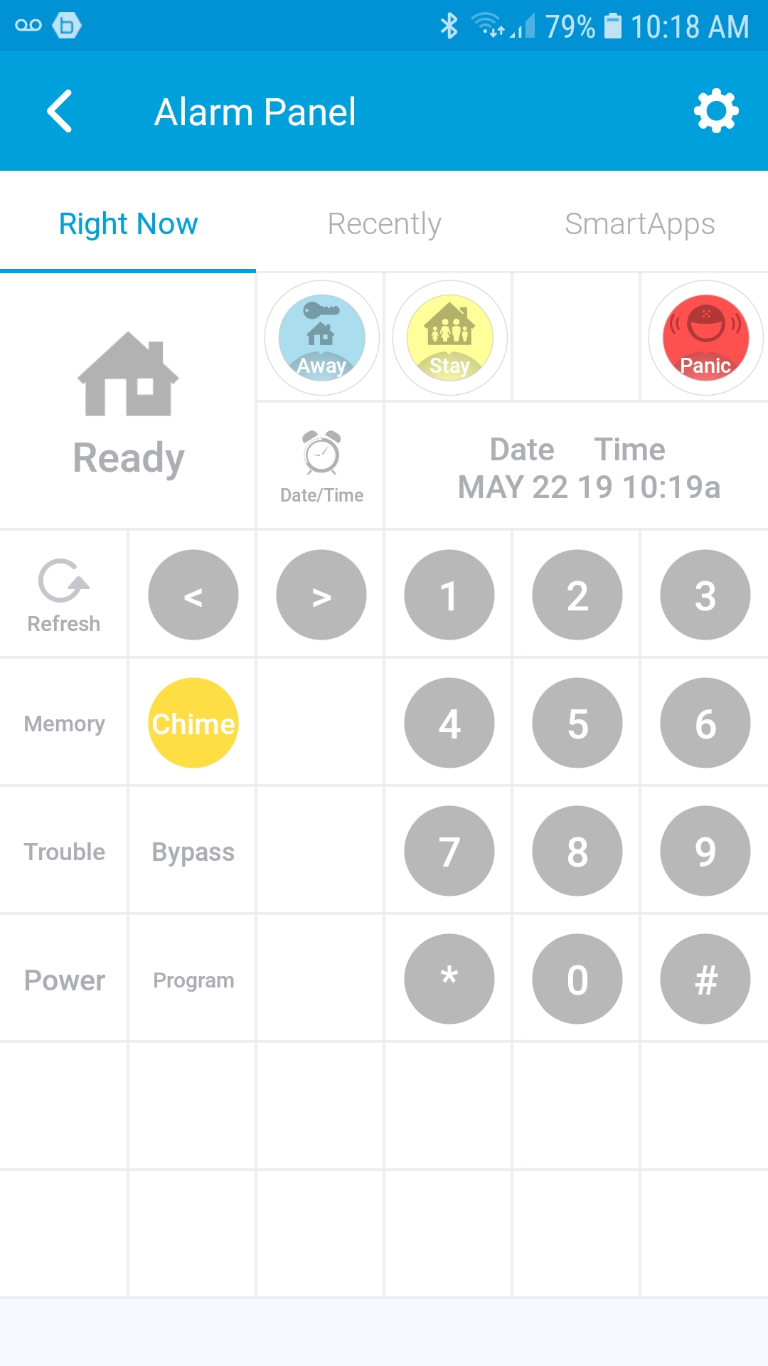

I split the functionality between a SmartApp and a virtual device. The SmartApp uses a REST api to the Raspberry Pi which is connected to the IT-100 via a serial connection. The SmartApp allows you to create devices for zones you wish to monitor for automation purposes (there are 3 device handlers - ‘Contact’, ‘Motion’, and ‘Smoke’). The SmartApp will update any zones that are define. You can also optionally add a virtual keypad panel device. After creating a virtual device using this handler you can add it in the settings for the SmartApp and the SmartApp will keep it updated. The panel will also display the zone number of any open zones.
