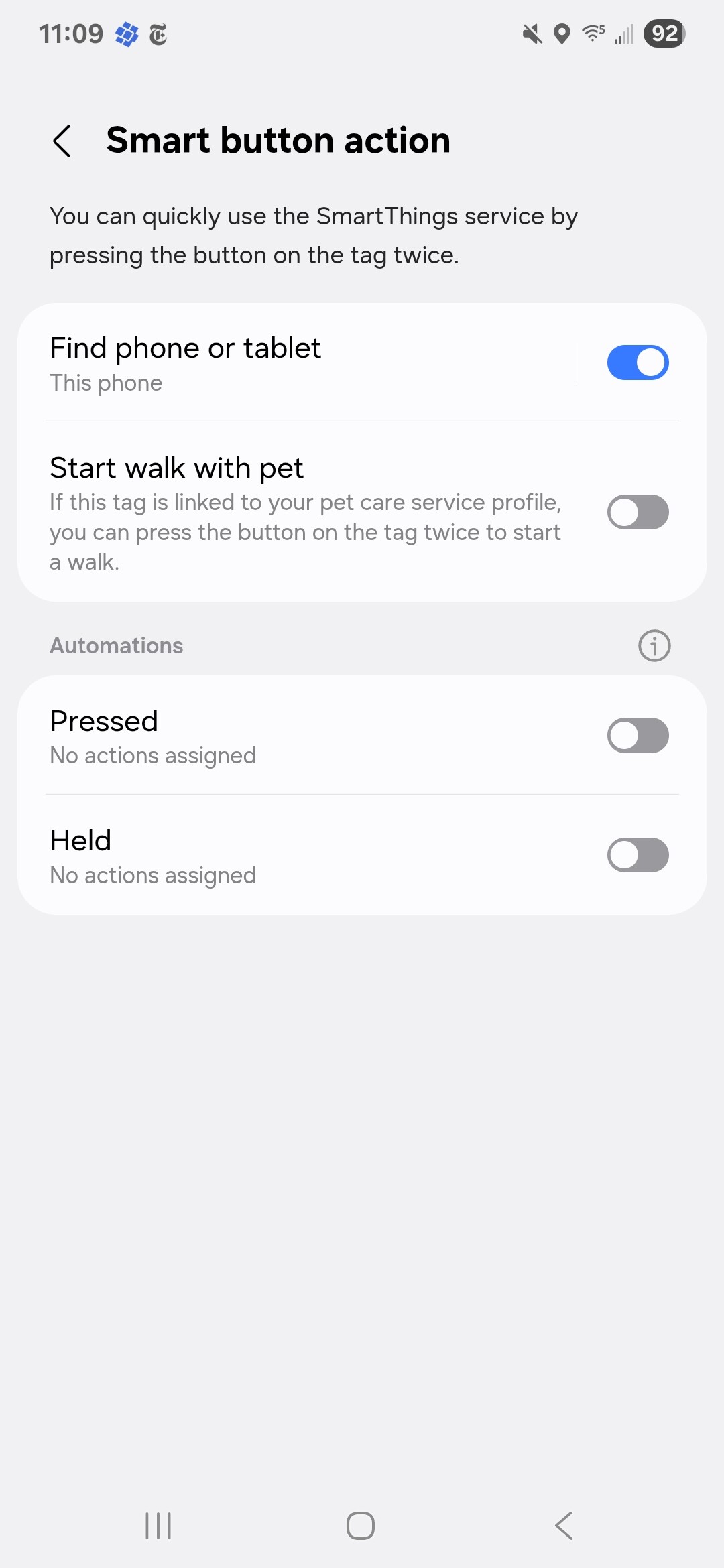

Where are you trying to set this up? You should be looking in the “Smart button action tab” and selecting “Pressed” or “Held” under the Automations label.
If you are trying to create a Routine, Smarttags aren’t available as triggers.

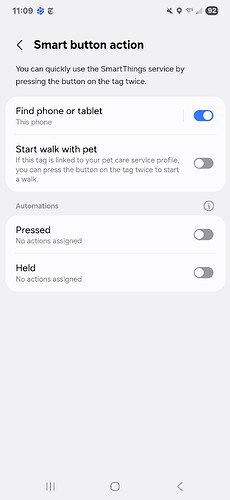

I select the “pressed” option, and then the lock is not available under the devices.

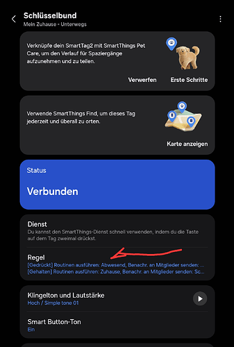

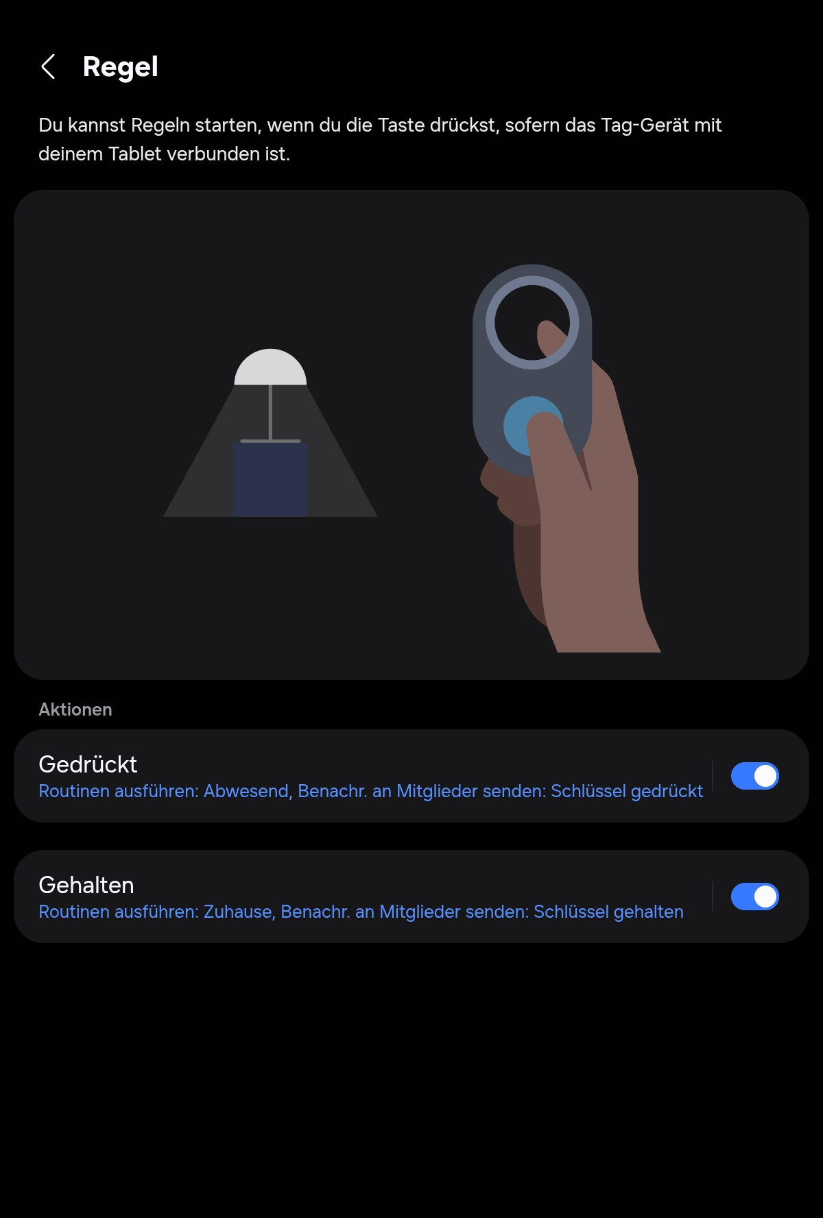

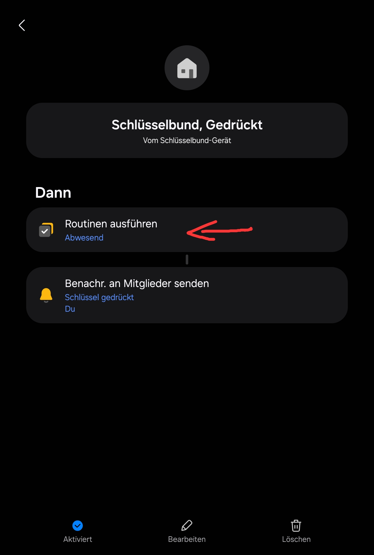

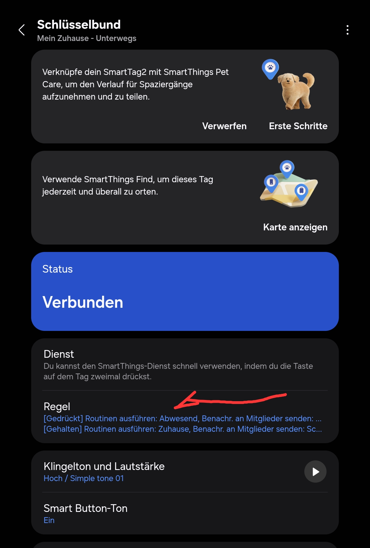

Create two manually run routines for lock and unlock and select them here (German, but you’ll figure it out):
Works like a charm here.

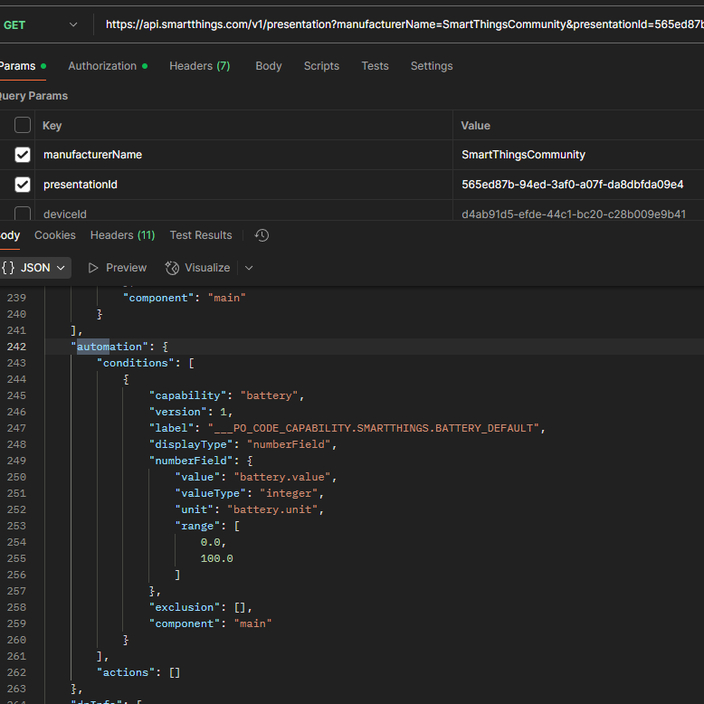

Checking its device presentation, I see it only has a configuration for “conditions” using the “battery” capability and has no options for “actions”:
So, that must be why it doesn’t appear in the “control devices” section.
In this case, @Ben_Bibbings, you need to contact Samsung’s Customer Support to ask if they have more information about why the device doesn’t this configuration since the manufacturer is the one that defines the device presentation.
