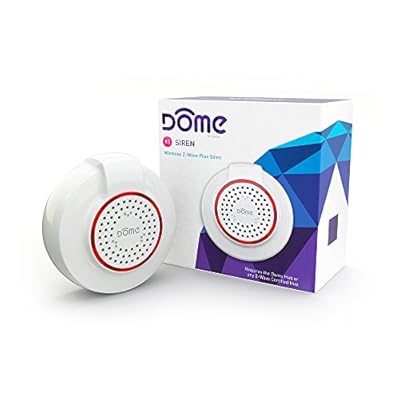

Has anyone tried this:
I just got it. Out of the box I am only able to turn the alert on and off at the default (mid level) volume. The manual includes the configuration parameters for the various other sounds and adjustments.
http://www.domehastore.com/store/images/pdf/DMS01-dome-z-wave-siren-operating-guide.pdf
Would love to use it as a door chime and an alert, but I’m new to Smartthings and lost by all of this stuff. Can anyone please help with a device handler?

This is great! This device handler has exposed all the functionality of the device and made it really usable. It’s not the loudest device available. I think the Aeon siren is louder, but this device is easily enough to let an intruder know they’ve been detected. Plus, having a two different additional chime sounds makes this useful as a doorbell and a delay notification, too. That’s a great set of functionality in one device, in my opinion.
