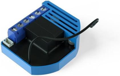

Quibino makes a motor controller that is supposed to be pretty good. But of course, you still need the motorized shades themselves. This is just the controller.
