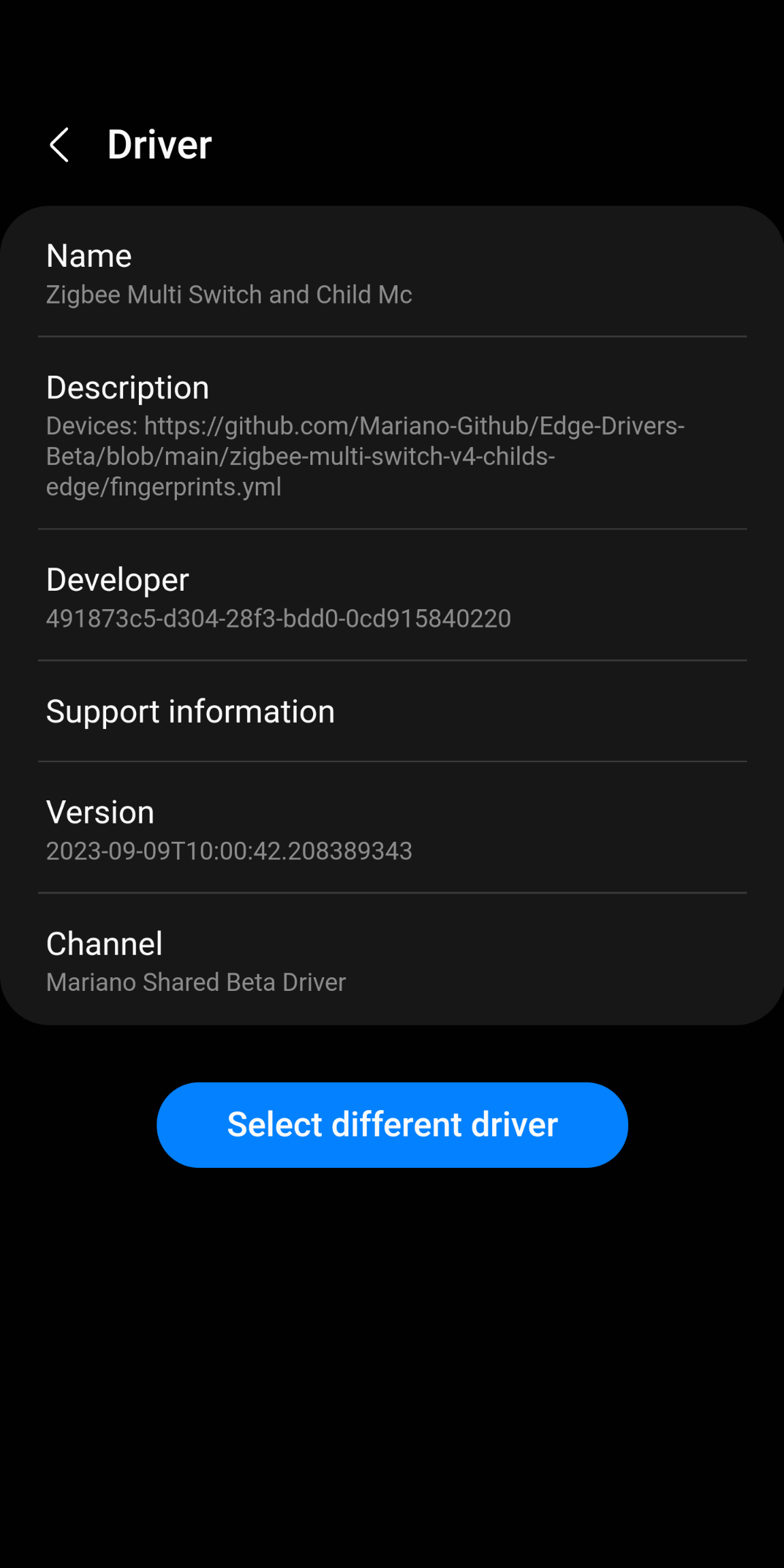

Try this driver version.
 Name         Zigbee Multi Switch and Child Mc
 Version      2023-09-09T10:00:42.208389343
Hi,
Still seeing the same behaviour although, my apologies, dimming to 0 does not.physically turn the switch off but does turn it off in the ST tile…
Hi,
Let’s see if I understand it correctly
When the plug main is off and you change the level, then the LED level is set, plug main = On is emitted and after 3 sec plug main = Off is not emitted?
When the level is set to 0 and the plug main is On, then the led goes off and plug main = off is emitted and the plug main is still On?
@TheHundredthIdiot @kiranmk702
Try with this driver version
 Version      2023-09-09T22:55:11.807041365

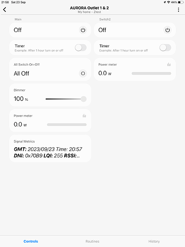

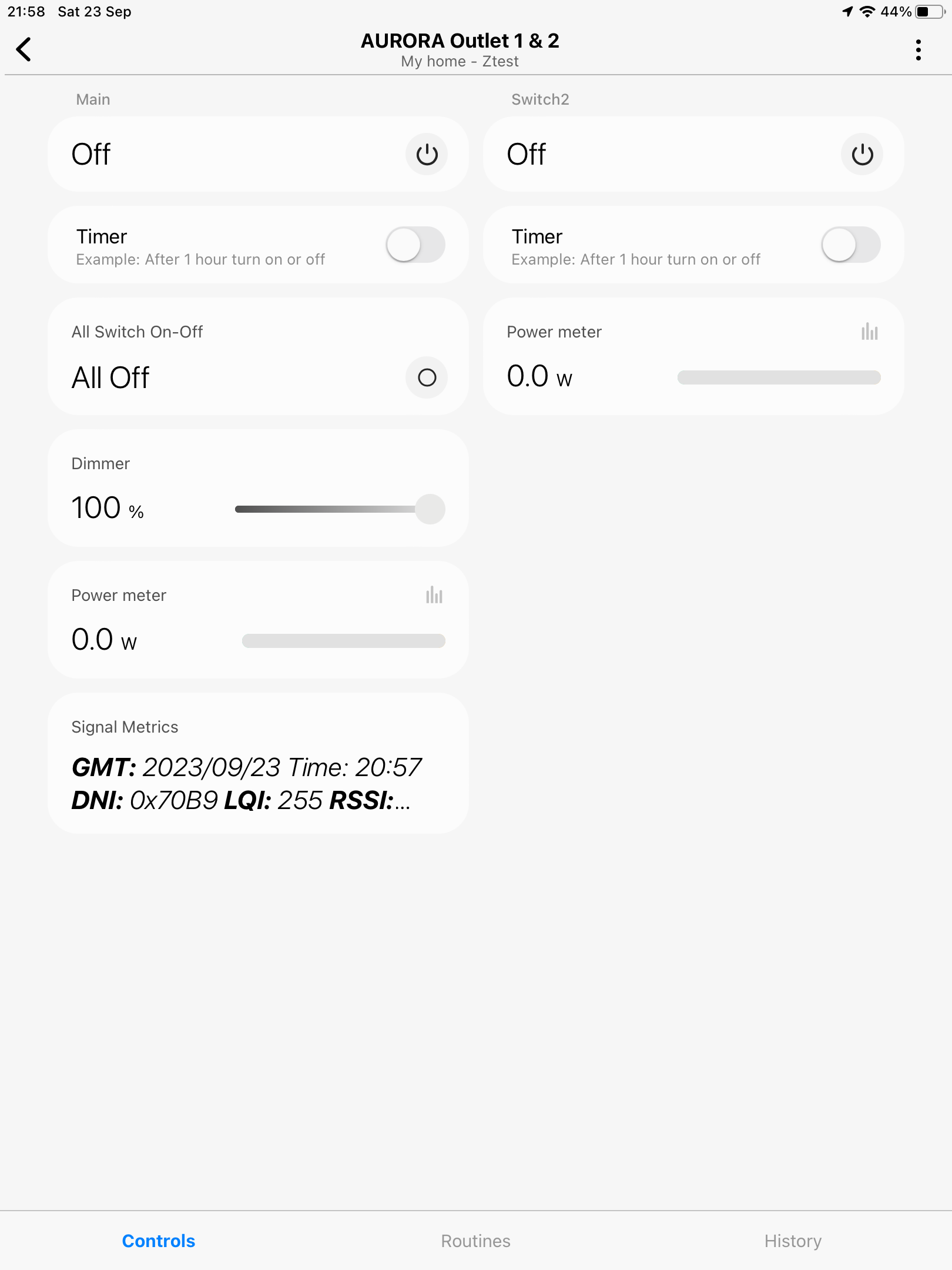

Hi @Mariano_Colmenarejo (again…),
A further observation/question that I hope the answer dows not turn out to be as obvious as the last one :roll_eyes:
I do not seem to be seeing power meter value updating for the slave switch (switch 2) in the main device whereas the main switch (switch 1) is fine, also there is no power usage available in the slave device itself - is that correct?
Amd signal metrics do not appear to be switching on/off just staying at default (on)?
Thanks…
Is correct, the child device has switch capability only.
Power meter is handled by defaults firmware libraries, then if works fine for main device it must be works fine for switch 2 component.
May be device does not send this attribute to driver.
It may not have been configured correctly if you matched it to the driver with a driver change from another driver.
You can try pairing it directly with this driver to see if it configures correctly.
If it doesn’t work and you want to send me the CLI logs of switch 2 working with load, I will analyze it?
The preference option for signal metrics only disable or enable them to be displayed in the device history
