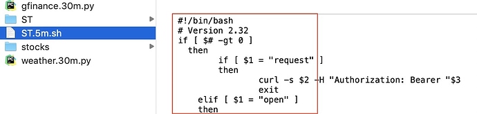

I just checked the ‘ST_Python_Logic.py’ python file on BitBar Github and noticed that, for some unknown reason, it is missing the required ‘#!/usr/bin/python’ header. Please click on this link to display the python code and copy is completely into the python file.
Here are what my BitBar macOS files look like when I verify them in macOS Finder. Please verify that your copies are named as I have them shown in the pics below and that the files are pure Python code and not anything else added.
