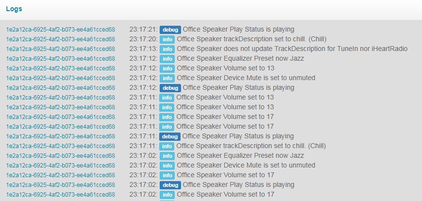

It did select the equalizer, and in the Logs I could see it was updated, on each press (albeit eventually).
But, when it was responsive the volume changed up/down with no issues, this is fantastic! Thanks to the recent change of not having to select “done” on the slider, it was changing the volume with each and corresponded in the logs (until it then lagged). I’ve also noticed the lag on almost all my devices of late, so I know its not your great DTH
