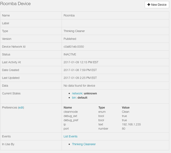

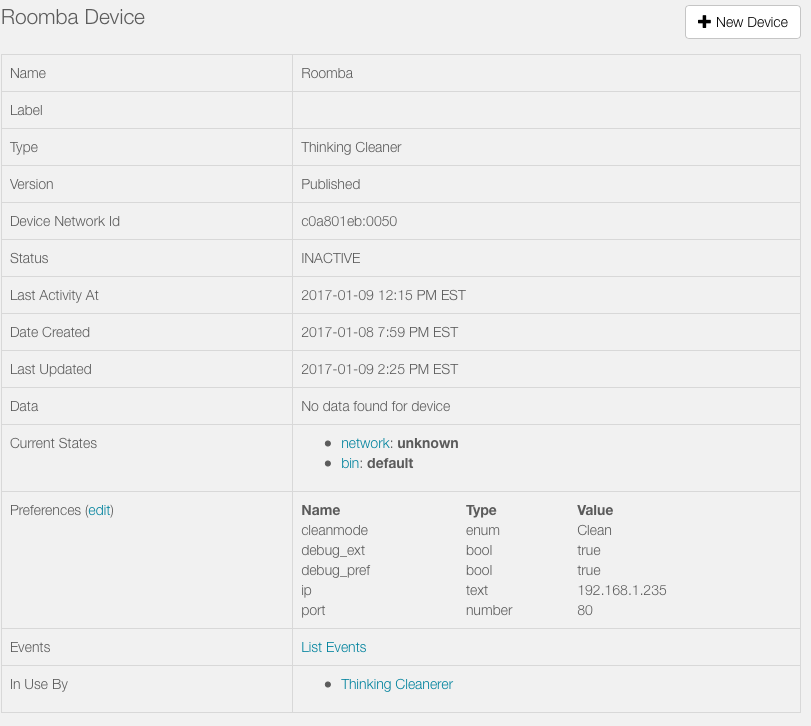

Looks like it is set up properly, but it can’t connect to the Roomba, hence the message “Network is not connected” in logs. Can you send a screen shot of the device in the IDE so I can see the device id.
The device ID looks correct to me. Argh. Thanks for all your help @pmjoen!
I don’t see a section for the hub it is joined to? Select edit and select your hub.
Oh my… That was it. Thank you for the back and forth!
