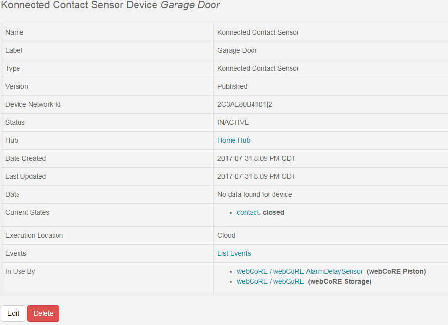

I’m on step 5 of the Quick Setup Guide. I have a real contact sensor which is on my garage door. I have a simulated contact sensor called AlarmDelaySensor. I have removed the Garage Door sensor from SHM. In SHM Delay Child I’m getting an error: The ‘Real Contact Sensor’ is simulated. Please select a different real contact sensor or tap ‘Remove’
The Real Contact Sensor is set to the garage door which IS a real contact sensor. Any suggestions?
Please go to the IDE devices and click on the device creating the error and send me screen shots for the device. Also please include the manufacturer and if it is wired or battery operated . After reviewing the information I’ll do what I can to create some code to allow the device.
Should you want to check it out
If Type contains the word ‘Simulated’ (case insensitive)
or
Data Manufacturer is null and Model Name is null and Battery state is null
either condition assumes the device is simulated
It is a wired sensor, hooked to smartthings through the Konnected Device Handler
Please update module SHM Delay Child via the repo or copy from github and let me know. Made a minor change to accept “Konnect” type devices as real, but am unable to fully test it from my location.
