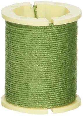

Floral wire! wrapped in cotton and comes in different gauges. 2 5ft lengths now monitor the sink base and dishwasher. I’ll attach some to a furring strip and slide it under the clothes washer and h2O heater. 4 areas monitored for leaks with 2 sensors for under $35. :slight_smile:
Now time to save for a shut off valve.
Can you give a little more detail on the wrapped in cotton portion? Any pics? Thanks
This is the wire I used.
You’ll need to tape/glue the cut ends to keep it from unraveling.
