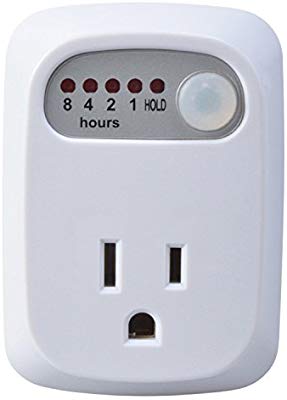

In this specific case you could also use a dumb outlet like the one linked below. You lose the ability to check it from your phone, but you gain some reliability in that you don’t have to remember to check it, it will always shut off even if your wifi goes offline.
