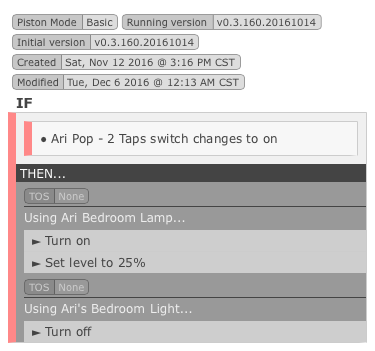

Can you post an actual screenshot of your piston?
Does your piston have any ELSE actions? If so, the OFF event is most likely to be the culprit since it will run the ELSE actions which most likely override the THEN actions. The TOS defaults to local which means, when an action schedules its tasks, it deletes any previously scheduled tasks for the same device, tasks that were requested at any time in the past and have not been executed yet. If this is the case, change the TOS for the ELSE actions to either Action (action deletes only tasks previously scheduled by the same action) or None.
A picture of the piston would help.
As for the two events being so close to each other, ST will spawn two instances of the piston, each dealing with its own event. Execution is not interrupted for any of them, although certain race conditions may happen where saved state is overwritten by the last instance to finish. Scheduled tasks reside in the state.
Here are screen captures of two pistons that both have the problem described above. I have a physical Logitech Pop button that is either double tapped or held to activate “Ari Pop - 2 Taps” or “Ari Pop - Hold” which are both virtual Momentary Button Tiles. Each Piston Mode is “Basic”, no “Else”, etc.
