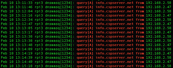

Hello. I recently switched my local (in-network) DNS resolver to a tracked service (nextdns.io ), and noticed a huge amount of queries to info.cspserver.net .
Looking closer, it appears two installed A/C units are querying the DNS every 30 seconds, each. What’s up with that? The 2 units are causing a considerable strain on the resolver, and are chewing through my query service allocation.

What brand of A/C are you talking about? Is it connected any way to SmartThings?
It looks like info.cspserver.net queries only have a 60 second TTL so that behaviour may not be that odd.

The A/C is Samsung AR9600 I think. AIUI, it’s just paired to an application on 2 phones, no hub.

Thanks, that indeed seems to be the case (I’m not going to investigate what sort of service warrants these super-frequent queries, or what the AC is communicating to have to query continuously).
I’m probably just going to redirect queries for this name to an unmetered service.

And it is definitely belongs to Samsung:
Domain Name: cspserver.net
