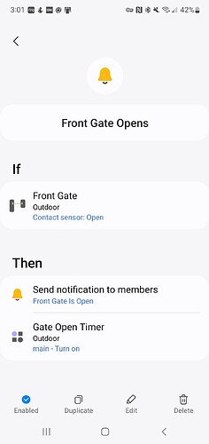

You could also use an Edge driver like the Edge Counter Utility to accumulate a specific amount of time and then trigger an event when that amount has been reached. You then reset the timer to zero and the process repeats. Here is an example I use to notify when a gate has been left open.
