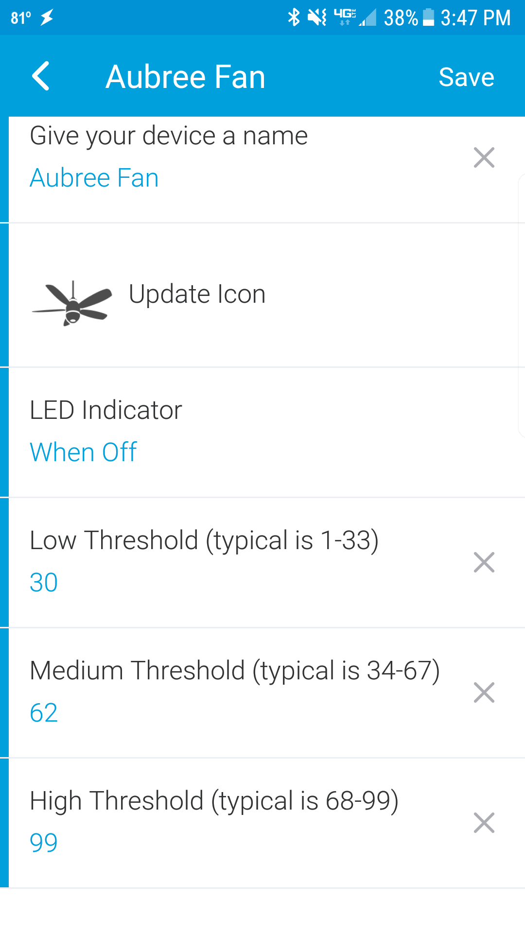

I can’t remember if you can set them under the gear icon in the app or on the IDE in the device settings, or both. Some of mine were blank vice having say 33, 66, 99 for the low ,med, high setting.
I don’t remember what DTH I’m using. But this is what I see in the gear icon in the mobile app.
You shouldn’t use the default dimmer handler because it’s not a dimmer. It’s a fan control. Set the device handler to the correct one and set the parameters in the fan to the correct speed. How are you trying to change the speed on the device itself? When you hold down for a few seconds it should change from high to med. If you continue to hold, it will then drop to low. The blinking of the LED will change. You can then use the up/ down arrows inside the device in ST to move the “dimmer” up and down until the speed changes. That should be your threshold setting.
