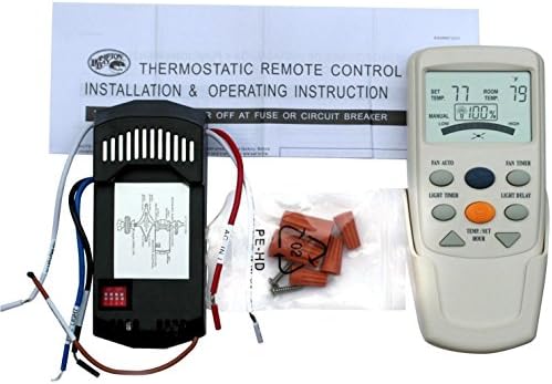

THere are legit ways to skin this cat. Wireless remote like
Universal Thermostatic Ceiling Fan and Light Remote Control Conversion Kit
OR mount Aeon Micro Smart Switch or dimmer in light housing to switch or dim lights only. Then you’d switch the fan at its local pullswitch.
