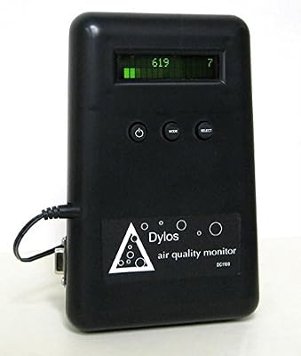

This way, we can measure co2 in ppm, co in ppm, etc. I have a cheap laser particle sensor:
That also measures particle size in ppm.
