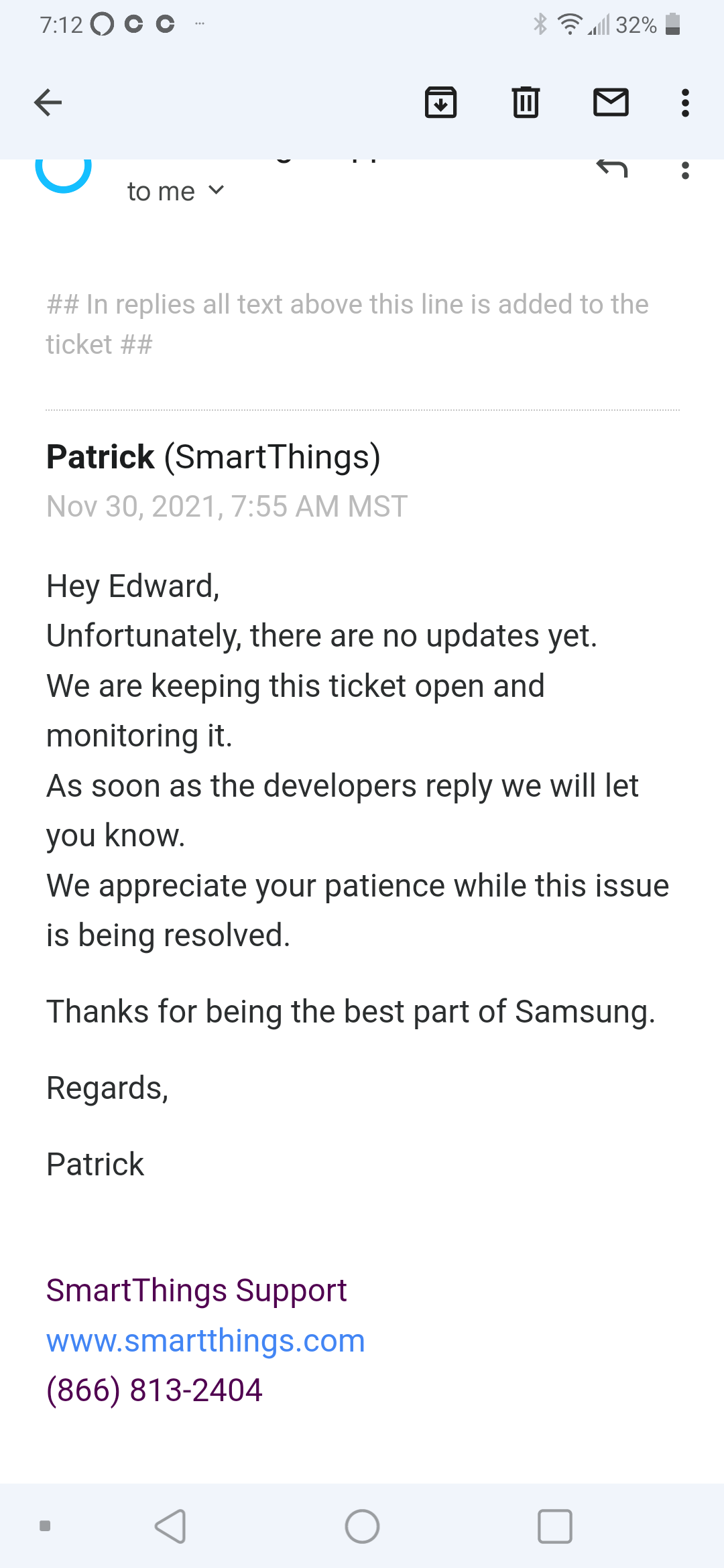

Do me a favor open a ticket with Samsung and reference my ticket. That can speed up the process if they see more people reporting the problem. Ticket info below. I also attached an image with number.
[SmartThings] Re: 1255862 | Customer is trying to connect Verizon Tracker but it stops at 99%
