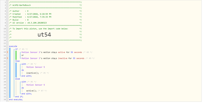

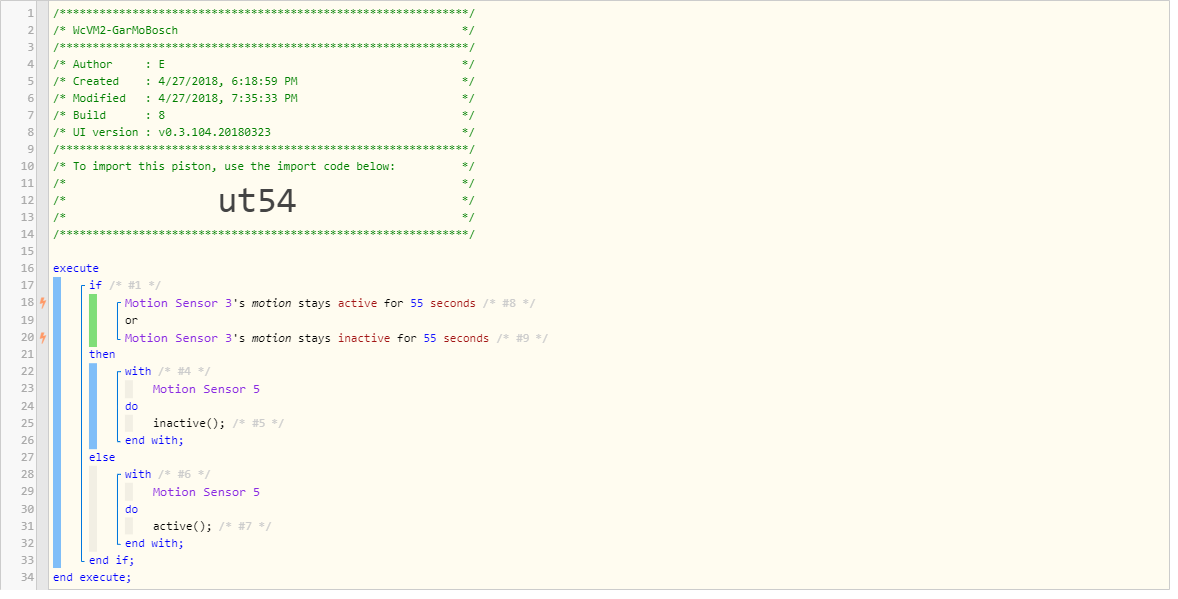

“Motion Sensor 3” is the physical Bosch sensor that sometimes sticks Active.
“Motion Sensor 5” is the Simulated Motion Sensor.
This will not address the 3 minute delay which is built-in to hardware to maximize battery life.
