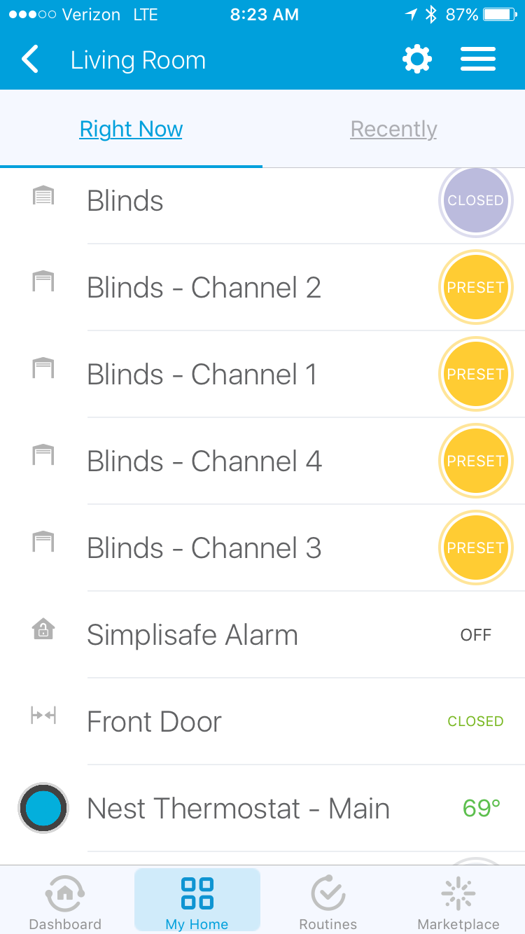

I have a Somfy 5 blinds channel setup for my 5 bay window. Channel 5 controls all of my blinds and the the other 4 channels control the other window individually. 90% of the time I use the “All Blinds” channel to control my blinds but when I do so, the other blinds status doesn’t sync. (See below). I know one way to work around this to create a Rule Machine rule to duplicate the commands to the other blinds a minute after I issue a command to the All blinds channel but it’s messy and sometimes move my blinds back and forth. It also prevents me from changing their state quickly if I issue the wrong command by accident. I am looking for a way to copy the status of my All Blinds channel to the others without actual issuing commands to my blind controller. Does anyone have any suggestions?
