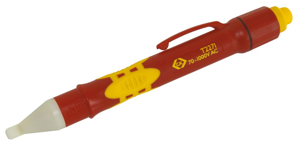

Something like that, again, if your not sure, get some one in to sort it, and before you do anything make sure the power is off…
i use something like this to double check, you don’t need to touch the wires just hold it near them and it will light up if there is power there
