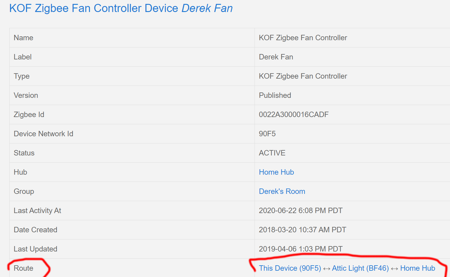

On a lark, I decided to look at my four fans, and saw this in the IDE:
I don’t know if the ā€œpathā€ setting is new, or if I just never noticed it, but I do have a smart bulb in the attic so I don’t have to reach for the switch. It would appear that all four fans in my house are connected through the attic light. My hub is in one bedroom closet, and two of the fans are in rooms right next to it…but my attic light is right above the hub. Interesting that they’re all going through that light. Heck, even some of my door sensors are going through it. Can you put a light (or peanut) in your attic?
[EDIT] There’s a ā€œPathā€ for Z-Wave as well. Cool!
