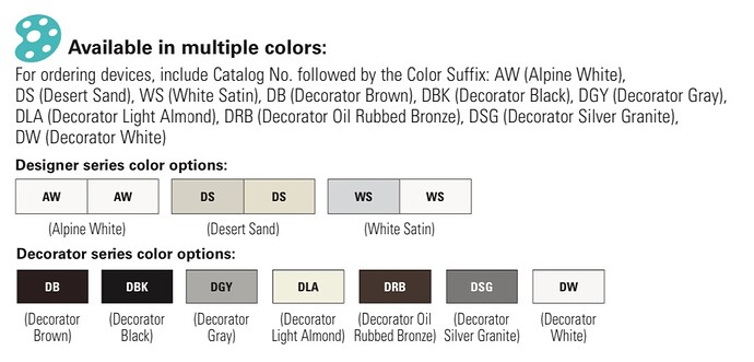

I personally like Eaton Cooper devices, and they have a new S2 model, RFTR9605-T, blue Led. And it’s specifically designed for switchable outlet functions, with an accessory switch option. They have their own color palette which matches their own switches but might not match other devices. I really like their silver granite, personally. They also have a configurable “power on“ feature which lets you decide what you want the outlet to do if the power is cut and then restored.

The suffix in Cooper devices is the color and design code. The T is for tamper resistant. So AW is “alpine white“ etc.
