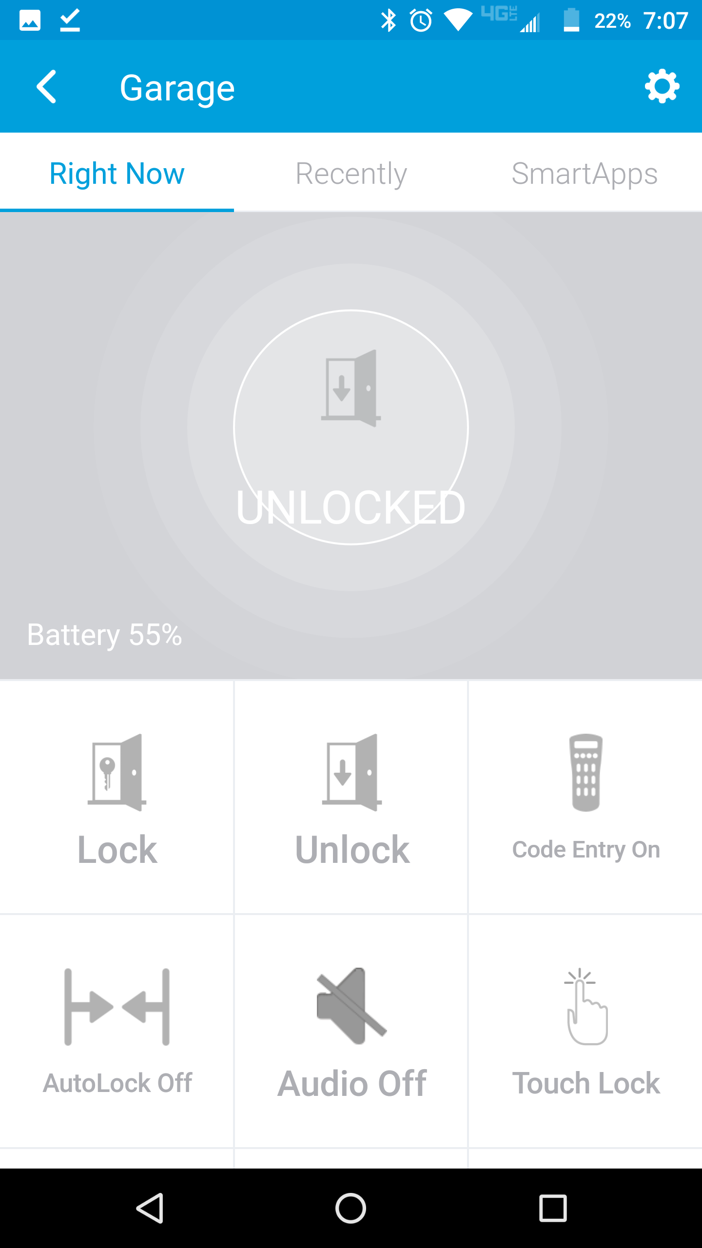

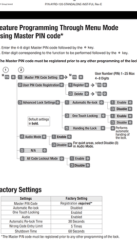

The Auto Relock and One Touch locking are two separate functions, at least on my T1L (YRd120-zw) locks.
You are looking to turn the Auto Relock off so that it doesn’t lock if you have the door open, and turn on the One touch lock. However, if you press (on my lock), the lower left hand corner it will lock the door regardless if it is opened.

In order for the Z1L to have the Touch Lock work, there is a very very small spot on the lower left hand corner of the lock ( āœ“) that must be pushed for it to lock. If you touch anywhere else, it does nothing, so I can’t say I have ever brushed it and caused it to accidentally lock. Plus it sounds like your door is spring loaded to where it automatically swings shut. My door is just a normal door that you turn the handle, push it open, walk inside, turn around and manually close the door shut. It would be nice if you could have the lock auto configure it’s options immediately on the fly as to whether the door was in an open position and disable auto Relock until door was closed.
It almost sounds like in your case, you would be better off having Auto Relock enabled (let it Relock after 30 seconds) and disable the One Touch so that you can’t brush against it and have it lock on you. This way you always have time for the door to swing close and lock on its own versus the accidental locking. And then add a widget on the home screen of your phone that runs a Lock Routine (that’s your one touch).
