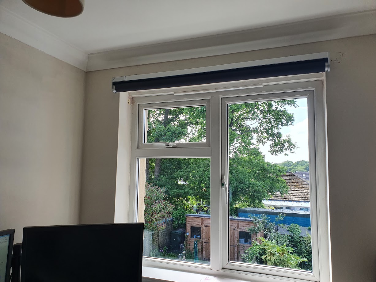

Blinds arrived and fitted today (Excuse the filler holes which I’m waiting to dry)
I ordered 120cm KADRILJ and didn’t realise it was the width of the material, not the entire unit so I ended up fitting outside the window recess (I find drilling inside the recess a pain anyway)
As you can see in the closed photo (it’s quite bright here today) they definitely aren’t blackout but weren’t advertised as such, more to offer privacy and sun shade.
Pairing with the new app was dead easy. Just press the 2 buttons on the unit and they were discovered straight away. I’ve set a preset for them to come to the window sill, it’s 46%. As a result ST thinks they are ā€˜partially open’ when I’d consider them closed. I need to figure out how to set the ā€˜closed’ length.
I didn’t play with the remote but from what I’ve read you can’t pair with ST and the remote, which kinda defeats the object to me. These are in my office, so only I use them but for other rooms I think I’d want to figure out manual control. Google assistant found them after re-scanning Smartthings but I’ve not tested out voice control yet.
My initial impression is that I’m pleased and will consider getting some more if I can figure out the dual control

When you get a chance, could you measure the end to end width of the blinds? Would be useful to see the difference between advertised (material) width and full width.
Glad to hear the pairing was quick and easy - I’ve seen a lot of reviews of these blinds and the one common complaint seemed to be the pairing process so maybe they’ve addressed that.
I’d love them to come out with more sizes or custom sizes but the latter will go completely against the IKEA business model so highly unlikely to happen I know.
I measured mine as 125cm. If you expand the ā€˜Product Size’ on Ikea website, it shows it as 124.3cm. Seems the are all +4.3cm width. It’s annoying it was hidden away and I didn’t notice it but the next size down wouldn’t have covered my window properly anyway, even though it could have been in the window recess
Samsung recently introduced native support for the blinds, so maybe that improved the pairing experience ?
Ahh thanks for that. My window is in a recess too and I’d like to put the blinds inside, but the width is 149cm. So the 140cm blinds would be 145cm which would leave 2cm either side so just need to think through how that would look. I might order them to visually check and return if it doesn’t look right.
