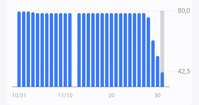

I have set up Smartthings hub and sensors 3 years ago. Quite recently (4 days ago) I updated my 4G router and it seems like all my sensors started to drain batteries in only few days right after. I didn’t have time to update router firmware yet, and just wondering could that cause the sudden drain in all sensors?
Basically same behaviour for all of them…

The above screenshots are from Smartthings waterleak sensor and motion sensor so I assume Zigbee?
