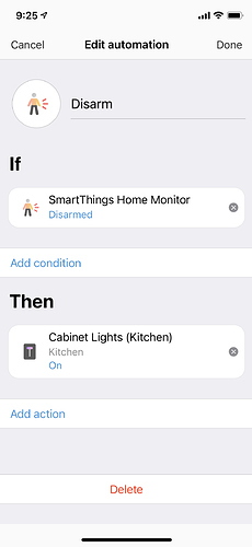

It doesn’t matter what actions I put under “THEN”. None of them fire. This automation does not run when I arm and then disarm the security.
Can you post a screenshot? Blackout any sensitive data
I just edited my previous reply with a screenshot.
Looks fine. So why can I get it to work and you can’t - that is the interesting question.
