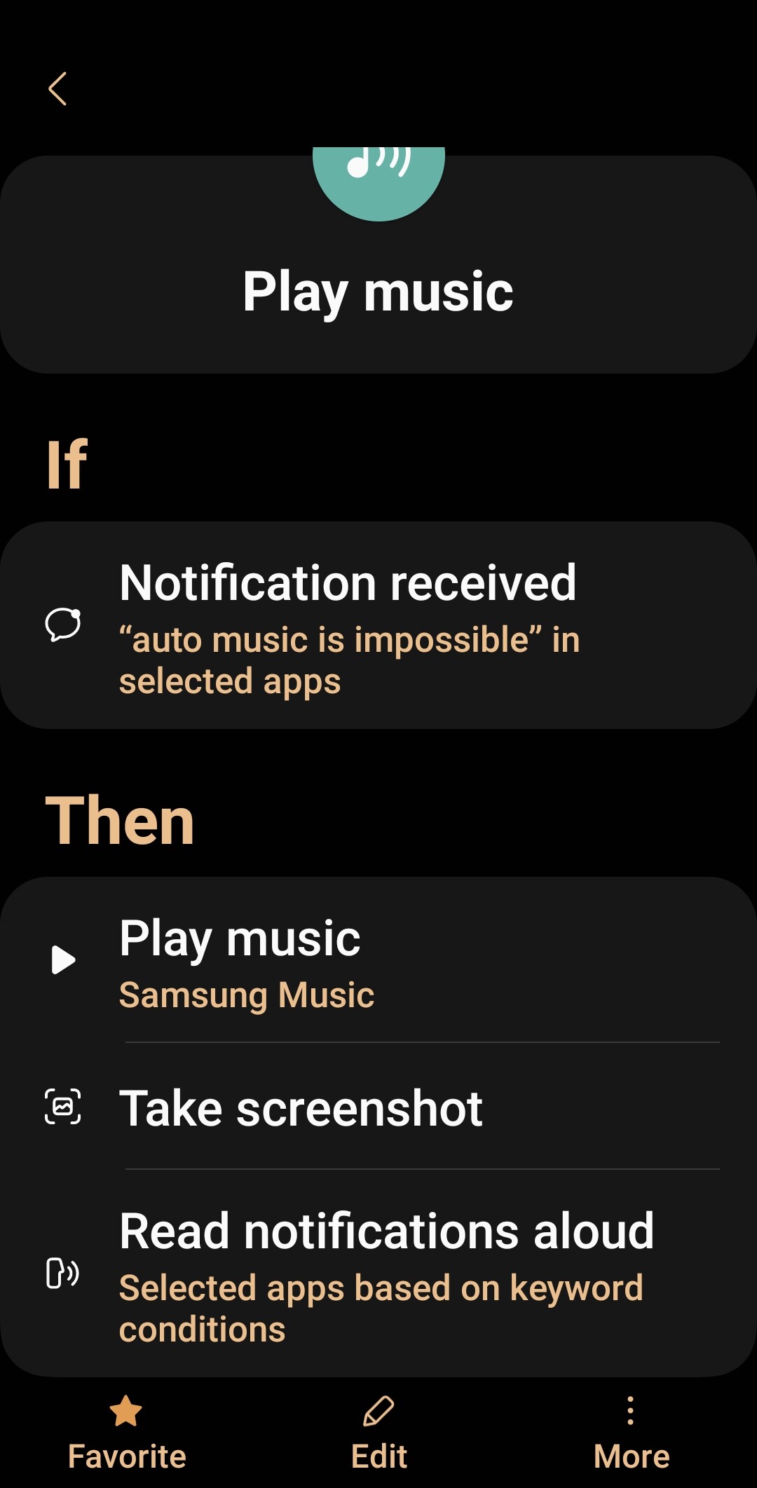

If looking to start the music playing with a routine, create a virtual device in Smartthings, there are various types and ways dependant on your needs, and set up a routine to notify you the device or routine is started, the notification must have a key word or 2, In bixby routines IF section, scroll down to ( Notification recieved ) type your key words and save
so every time you start the routine or it starts automaticaly, the virtual device opens/closes/switches on/off your call, the notification runs with the keywords, Bixby routines sees the keywords and the THEN part ( Open App ) - ( Samsung Music ) of the routine plays Samsung music and your favorites if required
I know you can use an NFC tag as a Bixby routine trigger. Can you also use the state of specific devices in your Smartthings account? Like a sensor or a light switch? :thinking:
Yes, but only with a notification set up in ST and Bixby IF will look for a specific key word in the notification
Light ON
ST notification ( Anyword )
Bixby IF

Notification with specific keyword
keyword ( Anyword )
hit the + sign
Bixby Then
Open an App or do an App action
Samsung Music
Favorite tracks or whatever is selectable
All pre installed on the device, no cost, simple and configurable
Its Not Rocket Science :slight_smile:
understood, however, looking back, this indeed is totally in-house after finding the solution from @fido
murica baby ! hehe
no, seemingly you cannot, Modes and Routines can only control Smart Things… Smart Things cannot control Modes and Routines, however… passively with the solution provided by @fido
it works! im amazed. it was only a slightly convoluted evolution. is it possible to select a specific song?

back on topic, seeing what Bixby Routines has to offer… its limited. wpuld love to see more options in the Then category
Bixby
THEN
Music
Spotify play lists
Tap one of the options
Select your spotify play list
it wouldnt allow me to select any of My Playlists. only suggested playlists. to select search… is there a way to automate “typing” couldnt not find a way to enter anything into the search box with ol Bixby.
tap a suggested playlist, it is a bit mis leading, what you see is a sugestion of mood or time
tap a suggested playlist which then opens your actual spotify playlists
