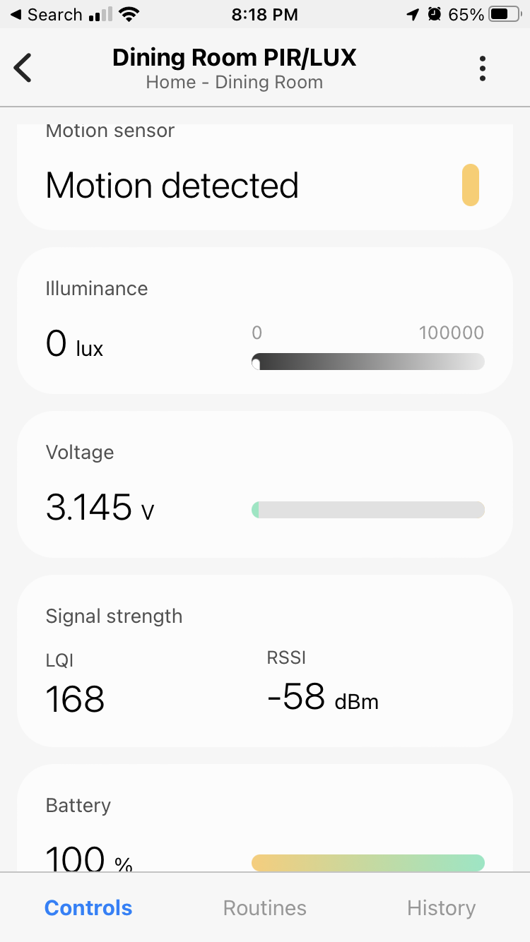

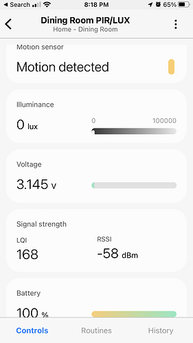

What edge driver do you use? Does it measure illuminance well? Because you are getting zero lux as value.
I had not come to that part yet. I was inside the edge but found nothing further for Aqara exercise.
Yes it’s works well. I took this at night. During the day it registers daylight
