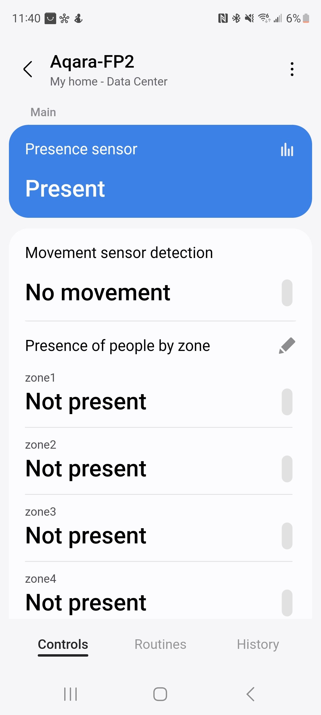

Do this (the SmartThings CLI part):
When it’s flashing, you have to add it to the Aqara Home app first, before you can add it to ST.
Try to add it by choosing the device directly - not by scanning:
[Screenshot_20241013_003515_SmartThings]
[Screenshot_20241013_003553_SmartThings]

I had the same issue:
PSA: turns out that if you delete and re-add the device often enough, adding it the next time won’t work.
[Screenshot_20241001_094534_Samsung capture]
[Screenshot_20241001_095623_SmartThings]
I successfully deleted and added it several times, with or without resetting or power-cycling it but one day it failed.

Got mine working last night when i saw the fp2 update.
Make sure no reference to it in SmartThings. I ran through app and advanced web to be safe
15 secone button cycle on FP2
While FP2 light is blinking detect with aqara app
Add fp2 specific device in SmartThings.
If anyone needs help still let me know.
