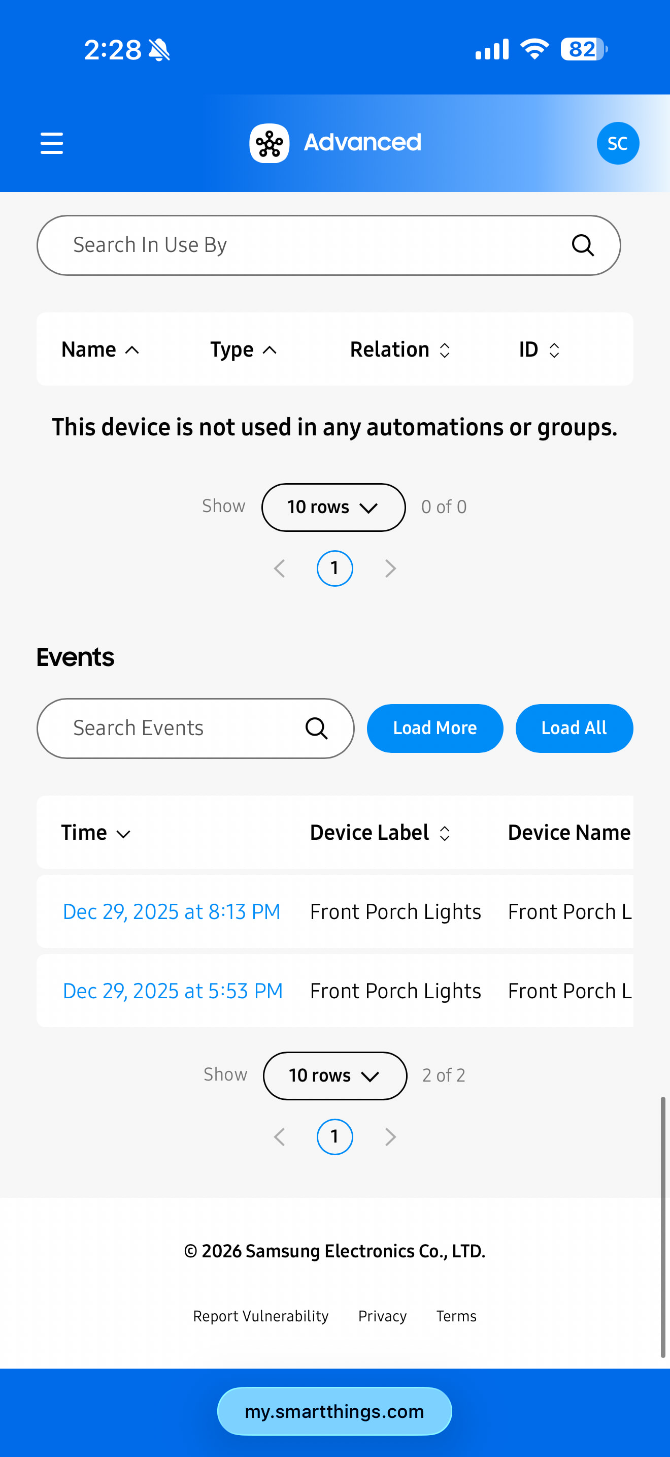

My last events are all on the 29th before the update. All my devices have a routine at 1015 every night and that’s the last night they completed it. So it’s clearly related to the update on the 12/30.
