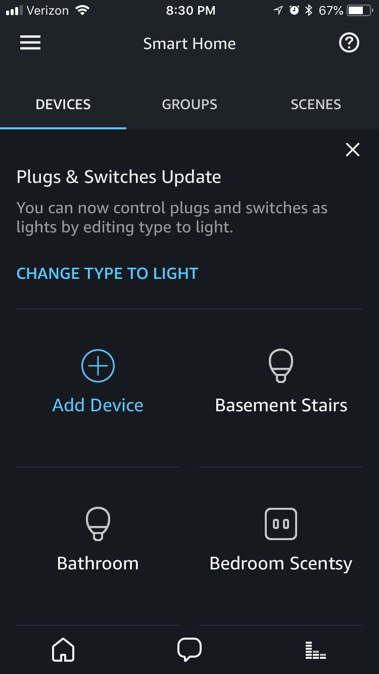

I’m trying to do the same thing, but it looks like the Alexa app (iOS) has changed, and I can’t seem to make this work. There’s no Smart Home item in the menu, though tapping Devices gets you to what’s probably the same list. When I tap on my lock, however, there’s no Edit to get to the Unlock by Voice.
Any tips on how to get to the Unlock by Voice switch?
For the record, the Schlage Connect lock otherwise appears to be connected properly. I can say “Alexa, lock the front door” and it does. I just can’t unlock it.
Click on the icon in the lower right. You’ll see your devices by type across the top. Scroll to the right until you see ‘Locks’ and click on it. Then click on the lock you want to be able to unlock via voice. On that screen, click on the three dots in the upper right. The ability to enable Unlock by Voice is on that page. You’ll be asked for a PIN# you want/have to use.

The image I attached is that screen. I got there with the steps you specified. There’s no Unlock by Voice.
Just to confirm, I loaded up the Alexa app on another iOS device and logged into the same account, with the same result.
What am I missing? Maybe a permission set somewhere else in Alexa/the app/ST/Schlage?

If you’re at the same version levels, check in the ST/Automations app to endure you’ve selected your lock in the Device Authorization section.
If that’s done, the only other thing I can suggest is to try to exclude your lock and re-add it. Maybe it’s not fully/properly connected.

Which ST app - classic or new one? I don’t see anything in either about “Device Authorization”, but I do have the Smart Locks app installed, see Smart Locks on my dashboard, and can address the Schlage by locking/unlocking or adding a new code.
I tried moving the declared location from Canada back to the US. That wasn’t it.
If all else fails I’ll exclude and re-add it.
I’m using the ST Classic app. To find the Device Authorization page, select’Automation’ on the bottom of the ST Classic App., then choose the SmartApps page. Once there, choose the “Amazon Alexa” smartapp. You just need to make sure that the lock is selected/authorized - or that the “Allow Alexa to access all devices, Scenes and Routines” is selected. It probably already is, but just checking.
