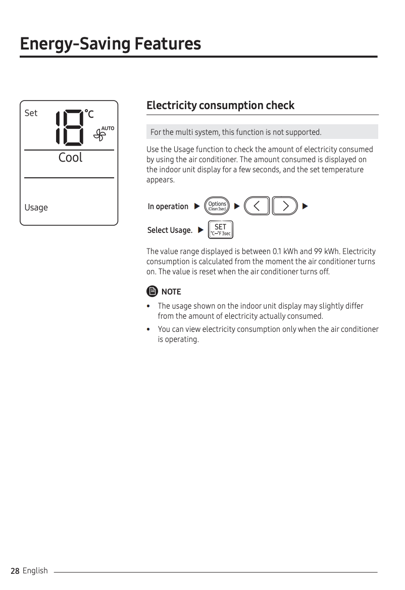

These that are not showing power consumption are in multi split mode (two devices inside, one outside). AC in single split mode is showing energy consumption.
Maybe it is related to https://downloadcenter.samsung.com/content/UM/202004/20200427164024644/RAC002-01_IB_AR9500T_GEO_WIND_FREE_EU_EN-WEB_.pdf
Hi @Piotr_Nielacny
Could you please give us more details? In the image you shared, it states that multi system is not supported, but you also mentioned that the devices which are not showing up are part of that system. Could you clarify this setup for us?

My assumption is that energy reporting may not be supported for multi-split configurations, which seems consistent with the documentation. However, since this is controlled by Samsung (not SmartThings), I wanted to confirm if this limitation is intentional or if there is any possibility to enable powerConsumptionReport for multi-split units.

Yes, do this page of the instruction is important.
And there is stated “For the multi system, this function is not supported.”. So Samsung will not report energy for multi split systems for some reason. There is no workaround.

The Samsung doc line — “for the multi system, this function is not supported” — turns out to be incomplete. More precisely:
