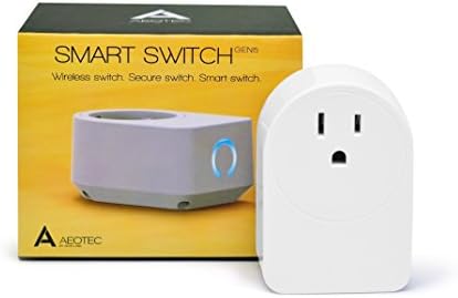

Aeon Labs ZW075-A02 Device Type?
So, I bought this Aeon Labs ZW075-A02 Smart Switch because it said it could report power. It paired as a “Z Wave Secure Switch” which does not have that capability. I am wondering which device type I should select to be able to monitor the power (for the Laundry Monitor app)
Thought I had seen it on one of the Better Laundry App posts (and thought I had flagged it to follow). However, I cannot seem to find it now. Does anyone know which device type I should/could use for that.
Tried “Z Wave Metering Switch”, but it does not appear to be polling. Am I on the right track there?
In case anyone else is having issues with it, the Aeon Secure Smart Energy Switch UK appears to be working fine with it.
