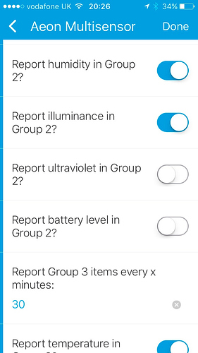

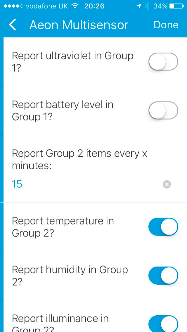

Ok Guys thanks for all your help getting these little devices up and running with ST.
So I have included with the Hub and installed the device handler john.fullman : Aeon Multisensor 6 Gen5 (Configurable).
I want to use this multi sensor in a bathroom to detect motion to activate the light and then when humidity exceeds a certain level (to be determined) to activate the extractor until the humidity reduces below a level (to be determined).
So Motion needs to be detected and reported efficiently and then Humidity is the next important data to report.
I have configured the device to 'Minutes until no-motion is reported to 0, Seconds until no-motion is reported to 60.
see below for the screenshots of my configuration -
When there is no-motion it seems to take about 3 mins to report, and I believe I have configured for 1 min.
I have also attached some Logging for review.
Any ideas to get this working as I wish?
BTW the device is currently plugged in via USB for power…
I’ve noticed that these Aeon Multisensors tend to have a lot of undocumented limitations and bugs. Based on my experience, here are some things I would try:
  • Make sure each output is in only one report group. I’ve found that having the same output in multiple groups makes it report erratically.
  • Try disabling real-time reporting. Even though the sensor reports the correct configuration according to documentation, I have never really gotten the desired behavior from this mode.
  • Try playing with your report intervals. I’ve noticed that if report intervals are set too low, the sensor doesn’t report as expected.
Good luck!

I have made the changes as you suggested
I am trying a 1min & 10 secs for no-motion. However it seems to fire after only 30 secs?
What have others set for mins & secs that work well?
Group 1(temperature & humidity) reporting 5 mins and Group 2(illuminance, UV & Battery Level) every 15 mins. Nothing reporting in Group 3.
I see the default value of illuminance threshold is set at 100. Yet it is currently reporting level of 12 lux. Isnt the threshold too high?

The “configure button” attempts to push the options selected during setup to the device. The device has to be listening for this to work. The “log config” button will ask the device to report the configuration it has received and push it to the live log. This is just to make sure that the config values I wanted were actually pushed to the device. The “refresh” button just updates the sensor values.
I just pulled the default config values from the documentation published by Aeon Labs. I think 100 is reasonable because it ranges all the way to 1000 I think.
