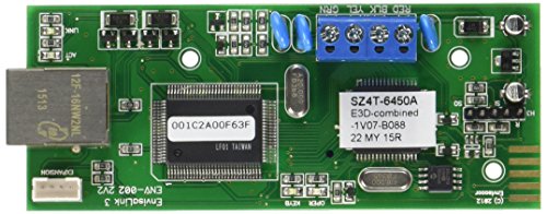

Just went to order and found this. EYEZ-On EVL-3 device which I believe is doing all of this in a single package. In addition to that company offering a monitoring package thats cheaper than my current one it looks like they have an API for all their functionality which should be easy to write a smartthings device type for. Has anyone tried this yet?
Arthur
Search the community for Envisalink and you will find lots of posts.
Yes, I have this circuit board installed as well as AD2PI Network Appliancei connected inside my Vista 20p cabinet. I choose not to use their API for control, but use the AD2Pi/RaspberryPi which came with a robust Python/API interface with basic example scripts. The AD2Pi also came pre-installed with the AlarmDecoder server system which allows one to access the Vista alarm console from any PC/mobile web broswer or iOS app.
The Envisalink serves to allow one to control the Vista 20p home security alarm system safely from Envisalink’s secure website for free. Installing an Envisalink board avoids having to open inbound ports on ones’ home network router for port forwarding since the Envisalink connects to their website and provides a secure two way communication with the Vista 20p (and other alarm models).
Envisalinks’ web server does not store your home alarms’ on/off codes. One must enter them when one desires to enable/disable your alarm via the Envisalink website.
The Envisalink website will alert one (or a group) via emails or text message (eg. emailaddress@vtext.com) when an alarm condition has been detected or ones’ Home Network cannot be reached (ISP Provider outage).
The Envisalink requires a hard wired ethernet connection. I was able to install a wireless repeater/bridge to connect the ethernet cable and make the Envisalink system essentially wireless. I also connect the Raspberry Pi/AD2Pi server to the same wireless bridge/repeater.
In my installation, I eliminated the monthly home surveillance costs and phone line charges with this Envisalink’s DIY product.
