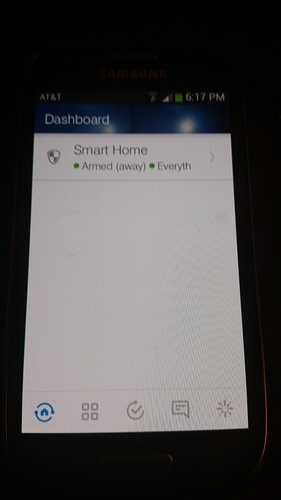

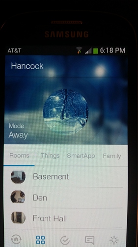

unfortunately that is not what is showing on my wifes phone. when she logs in it goes right to the 2nd location I created and there is no option on the top to select a location as shown in the video… I will post a pict when I get home and get on her phone again.
Notice no option to look at locations or change account info… ie bug.

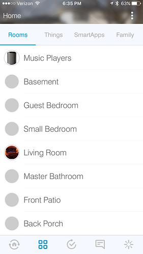

Sorry, catching up here. What is your version of the Android app you are using? I have never seen the dots menu not appearing like that.
Pretty much all the screens on iOS at least has the three dots…

More info. Reinstall didn’t help but her account worked on the nexus 7 so I realized itwas phone related and started playing more. There is not a lot of screen real estate on it … it is an sgs III mini running 4.2.2.
640x480 I.believe. so when playing around I realized the menu button on.lower left brings up what the dots usually do and.it works!. Thanks I guess the video or FAQ needs to be updated. Now she is bitching about all the alerts anyway. I will freeze it so at least it is ready to use if I am out of town and she needs to do something.
